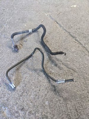

Here's another oddity. Looks like there's a fourth connection at the rear axel. One from the MC, one to each wheel and a fourth hose just sorta dangling. Used to be connected to that severed hose in the pic but that doesn't look like it goes anywhere

That dangling hose is your axle vent. You can clearly see where the hose was cut or torn, from the one clamped to the top of the Combination Brake Line Junction block/Axle Vent.

Thanks! So the fitting was totally clogged, I'm just guessing but I think this truck was used to put boats in the ocean. Should I bet on the axel just being full of water?
Let's hope not. I have always changed all my fluids when I bought one and was glad I did. Since the vent hose was clogged I would for sure suggest you do it just to be sure.
