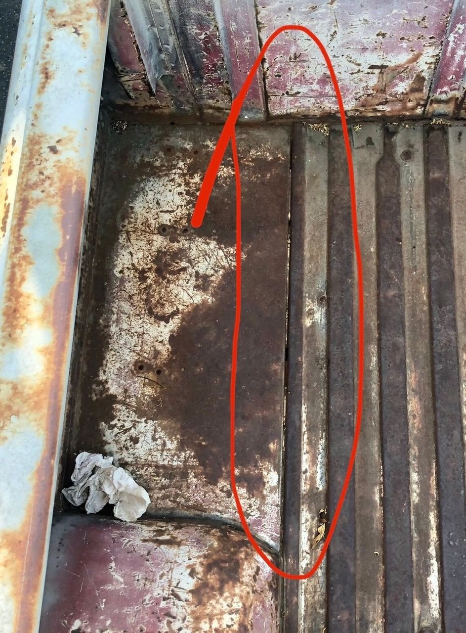

Bed Floor Seams
These are the seams in the front section of the bed floor. When the seam sealer fails, dirt and water are able to drain into the torque box under the bed.
I want to have the inside of the bed hydroblasted but I don’t want the blast media to wind up in the torque box.
Today I’m going to weld up these seams.

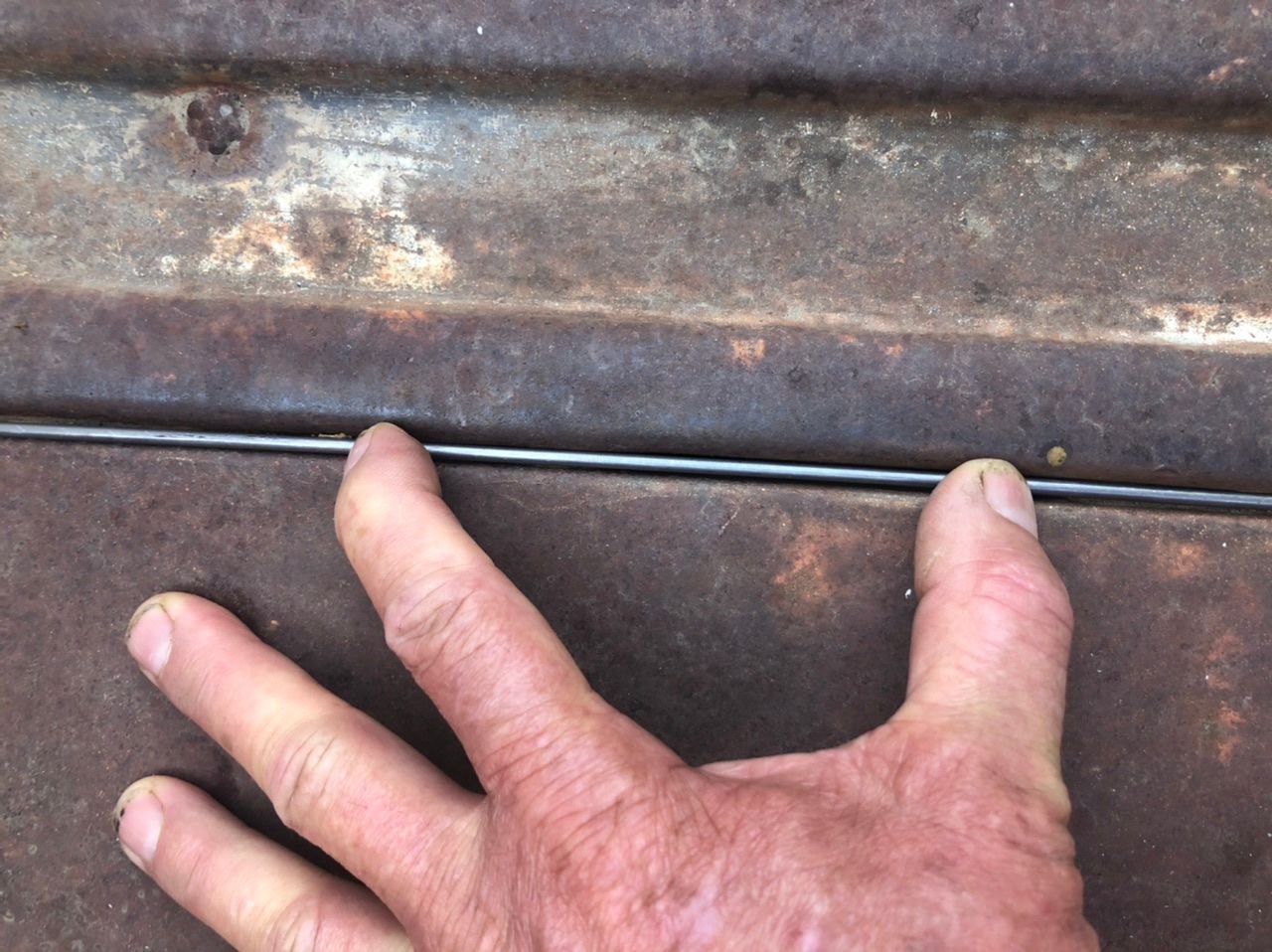

Old Jul 31, 2021 | 09:42 AM
BobbyFord's Avatar
BobbyFord
Joined: Jun 2003
Posts: 3,932
Likes: 282
That gap is pretty wide so I'm going to lay a 1/8" round mild steel rod in there and weld it in.
