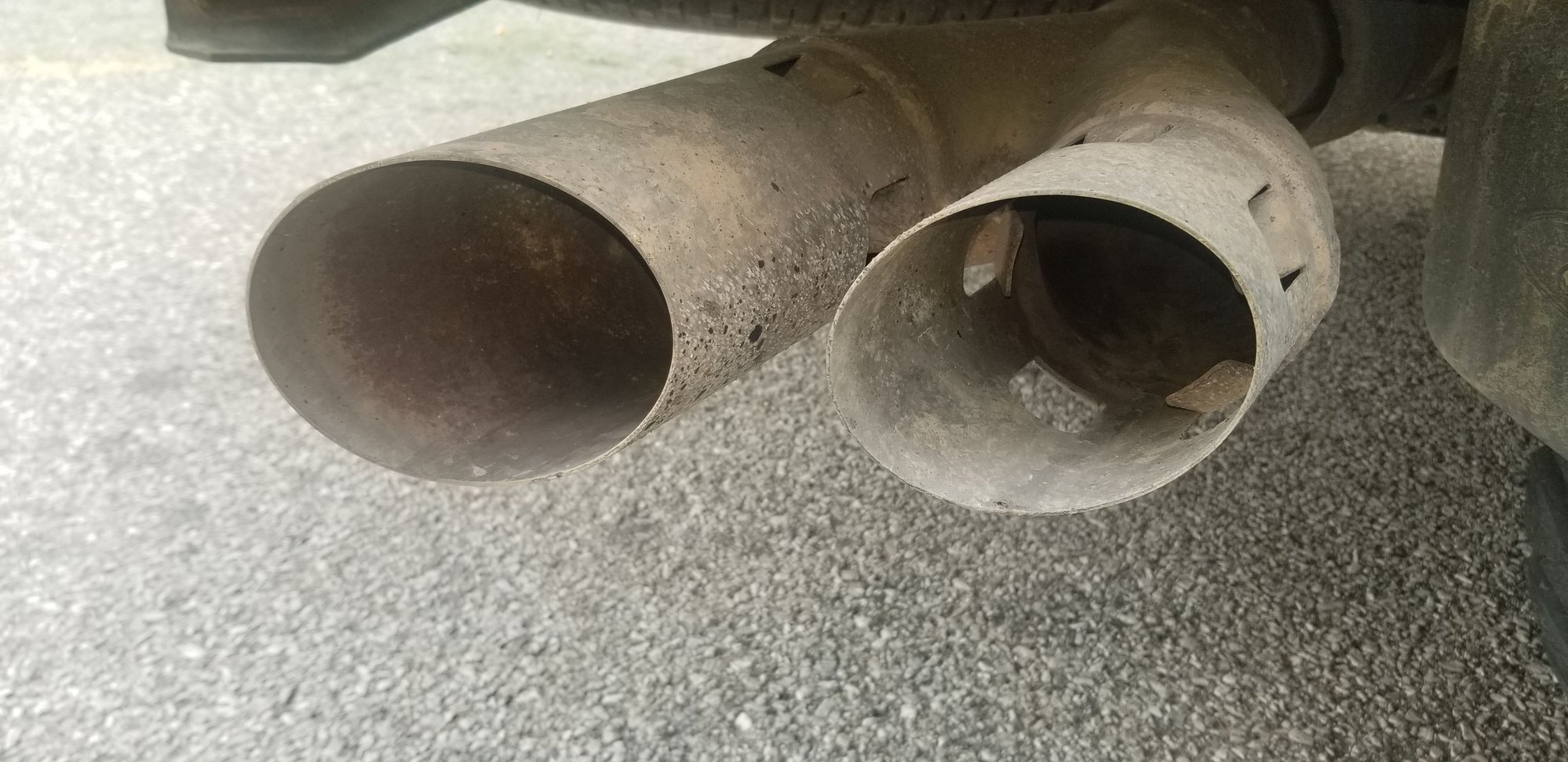

How do the tail pipes look? How many miles on the truck? What does all the EGT sensors read?

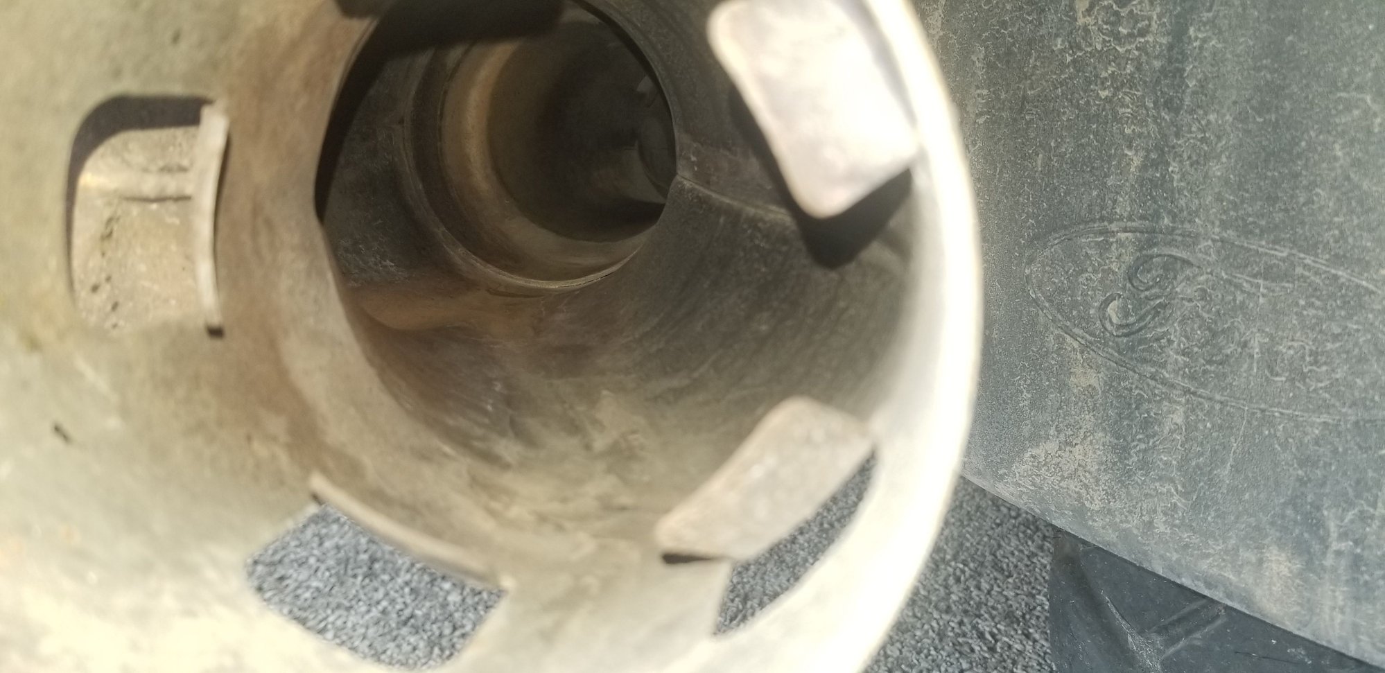

No other codes found, EGT numbers while driving and trying to regen, pictures of tailpipe

Those egt numbers are low, was thus at the start of regen?

In 10 miles those temps should around 900 to 1200 degrees
