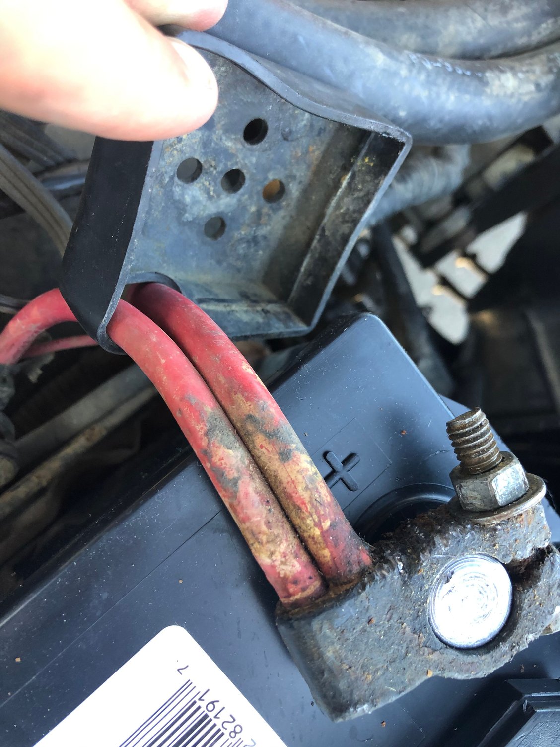

Here’s a pic of the terminal and cable as it is. Makes me think the wire is corroded somewhere down the line. Not to say it’s this specific spot. Just the overall condition of the cable.
just weird how it would work consistently for a month then during a long drive of 30 miles down a dirt road it would go out.
That doesn't look *great* but I've seen a hell of alot worse.

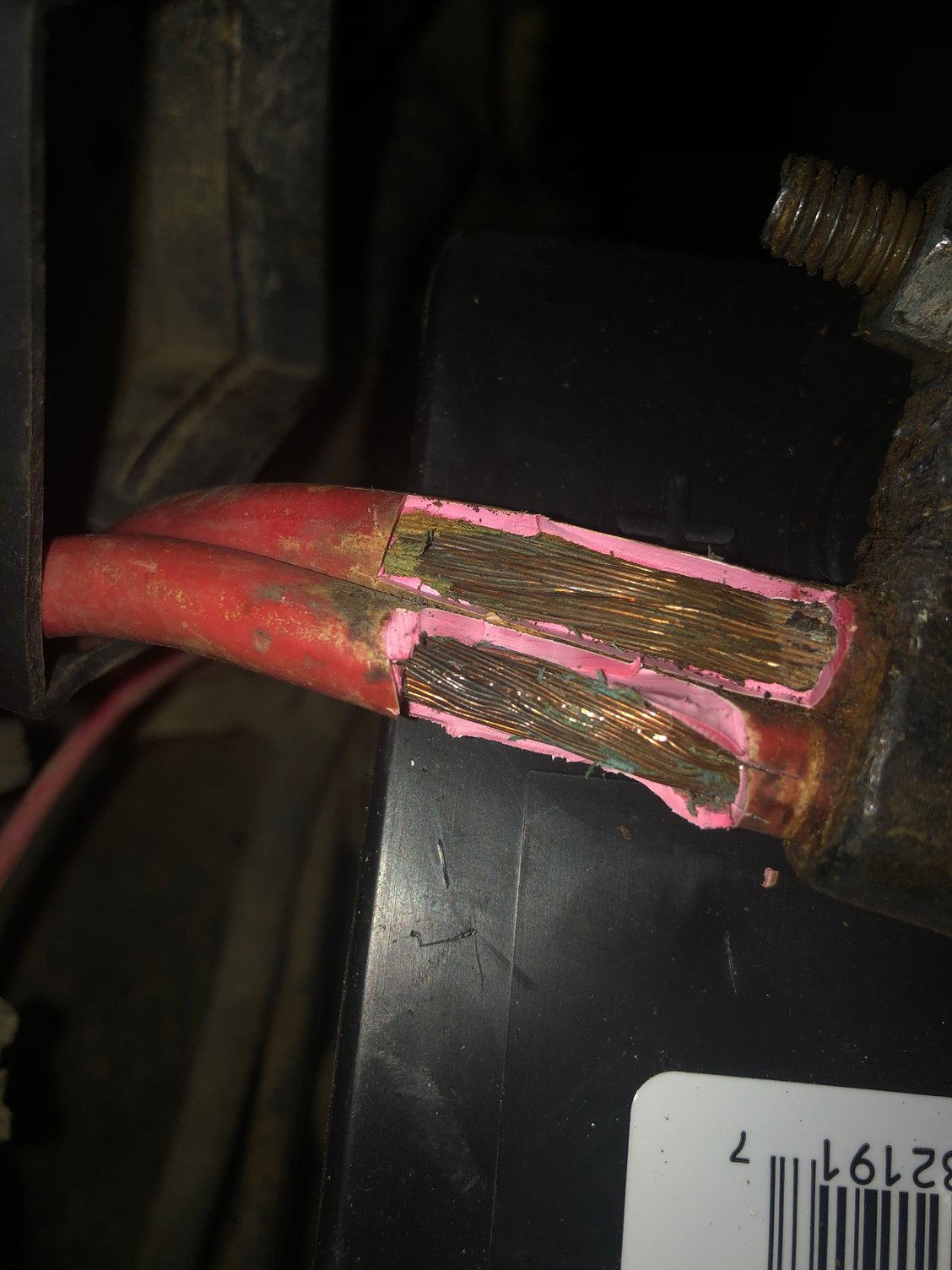

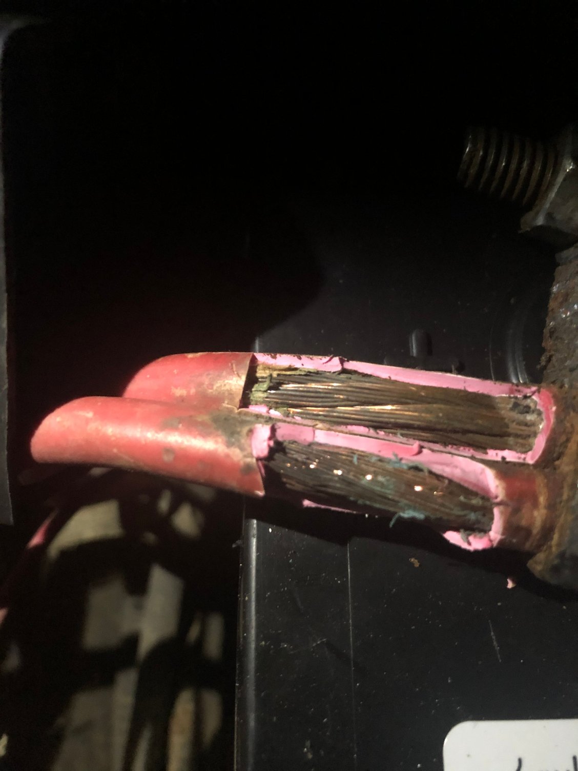

I ended up cutting it open to see what it looked like. Little bit of green corrosion but nothing crazy at least in that section.
do a voltage drop test from one end to the post and if it’s significant replace if it is in spec it’s okay.
