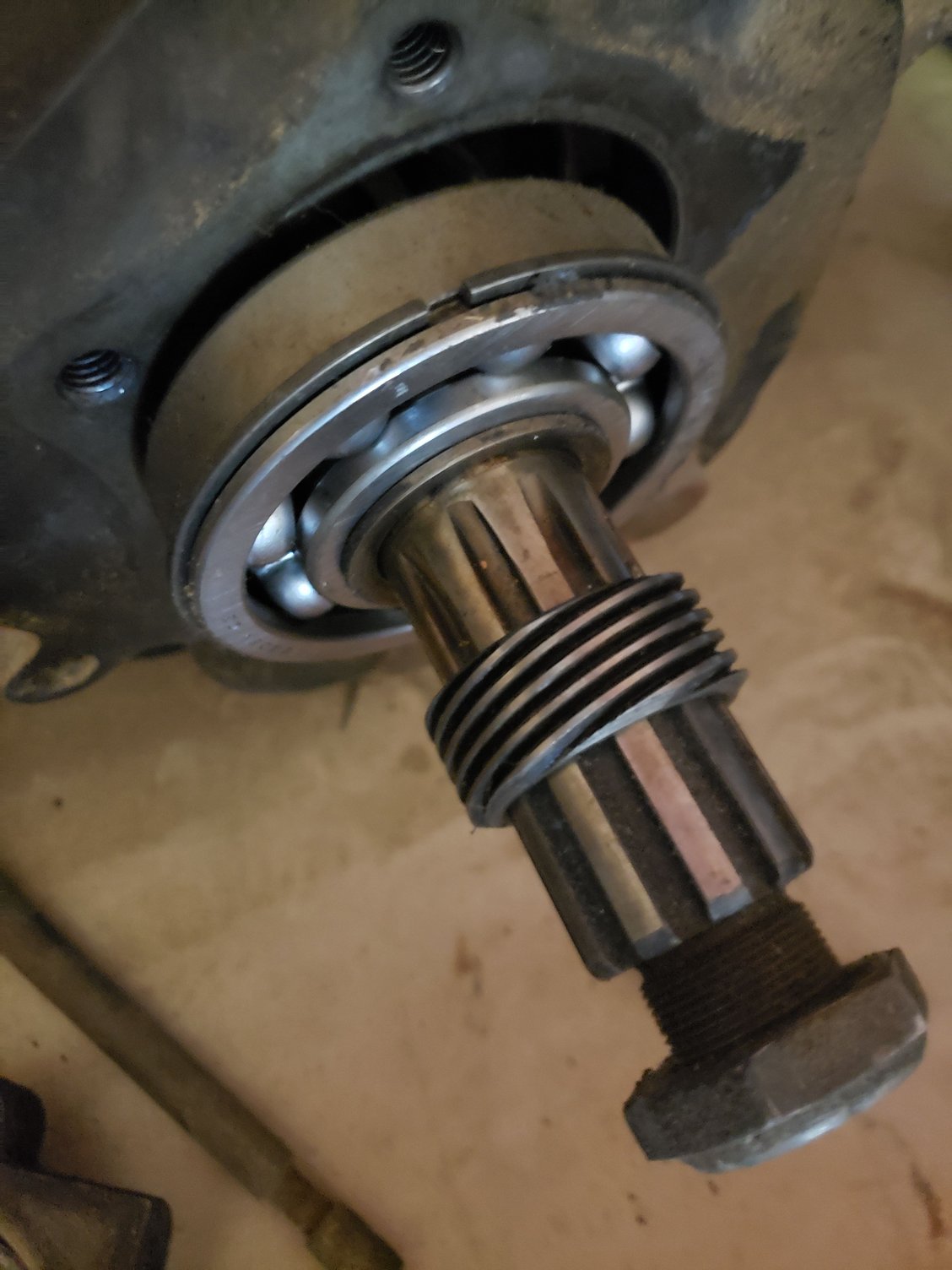

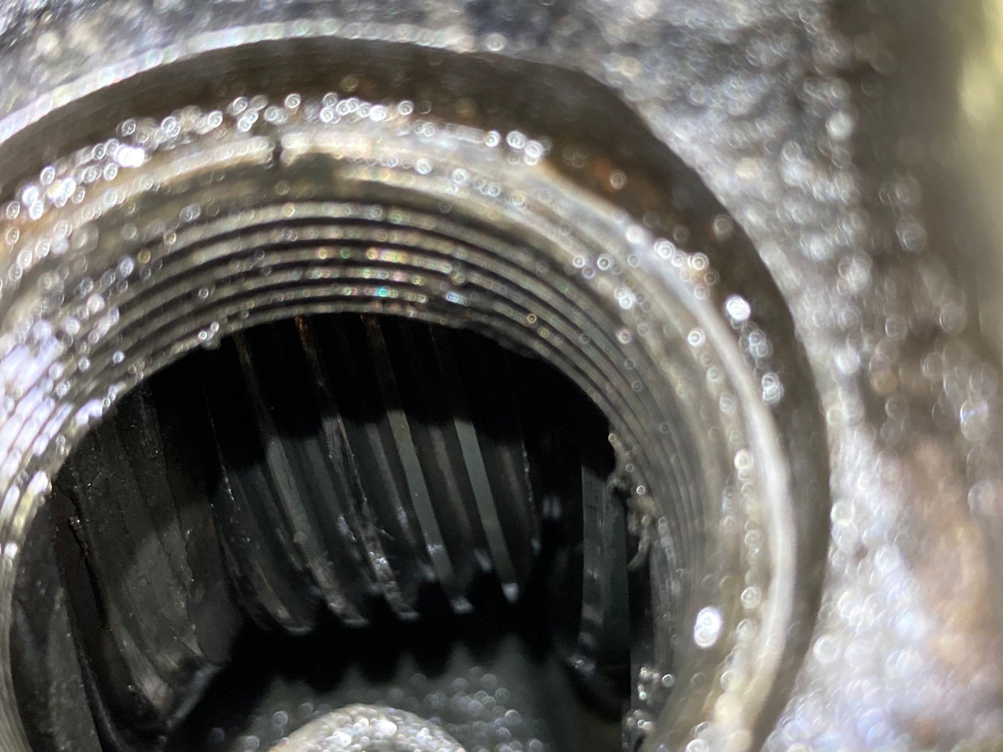

Driven gear is in a housing, but looking through where the driven gear is inserted, it looks like the is a hole where lubricant will drain back into the case, just guessing.
The worm gear looks like it might be in good shape, must be a lot harder metal than the driven gear as it was pretty chewed up. Talking with several transmission/driveline shops one has indicated that the driven gear and worm gear need to be replaced as a set, another said no. Any ideas?

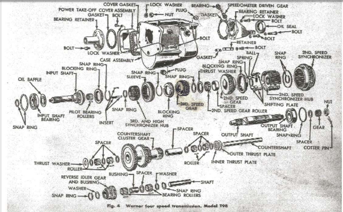

In the transmission diagram I do not see the worm gear that drives the driven gear?

Labeled as "gear" on output shafts. slides in outside of bearing.

Thanks JohnNewb, that makes sense. I new it had to be on the output shaft and suspected that gear had something to do with it. So flushing from the hole with the driven gear, the debris will have to make its way through the bearings to the gearbox. I imagine there might be some debris that is settled on the bottom of the tail piece. I might be able to get a suction hose in there to suck some of that stuff out.

I found a driven gear on eBay. $65. I am not sure why the old one got chewed up so rather than just plop it in I think I am going to drop the drive shaft and remove the tail piece on te transmission in order to check out the worm gear. Does that sound reasonable?

That sounds good to me, no use taking a chance.

Good approach. There is always a “why” when parts fail. This approach can save your new part from looking like the previous one. Don’t ask for my example...
