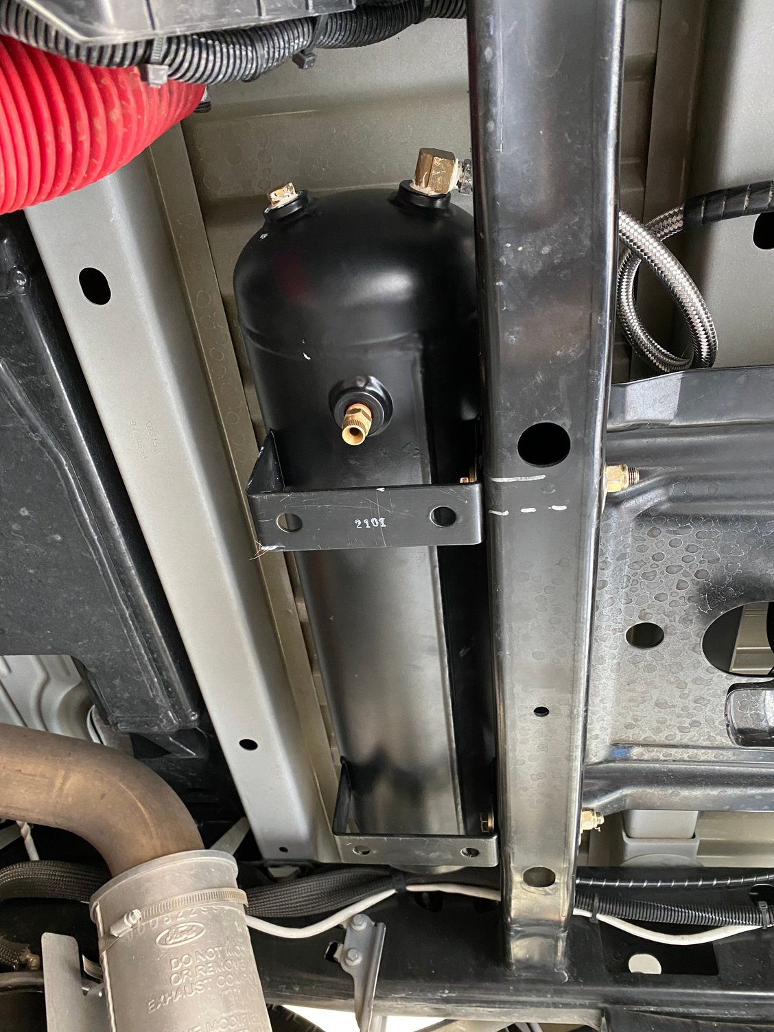

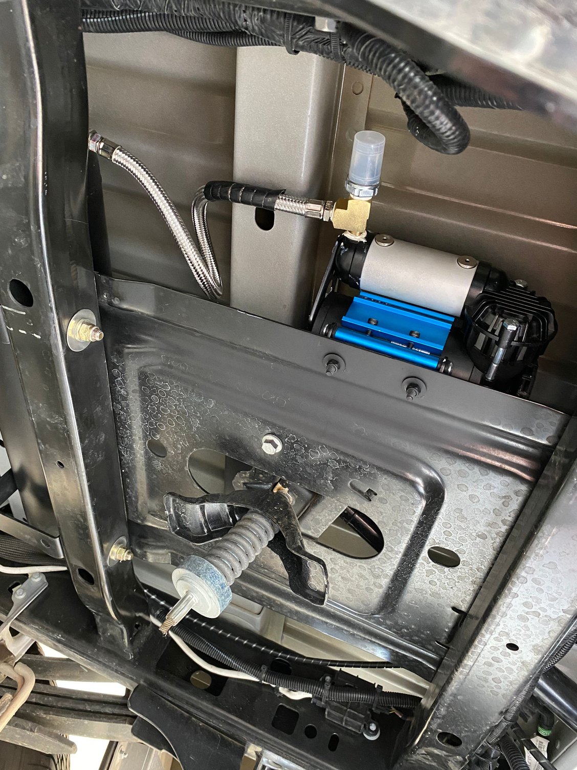

Ive always been partial to the ARB compressors. I mounted a CKMA12 single compressor and a Viair 2.5g tank back by the spare tire.

moynihan1129 - I used the ARB mounting bolts to mount it. The tanks was a trip to ACE for some bolts and drilled some holes in the tank bracket and spare tire cross member.

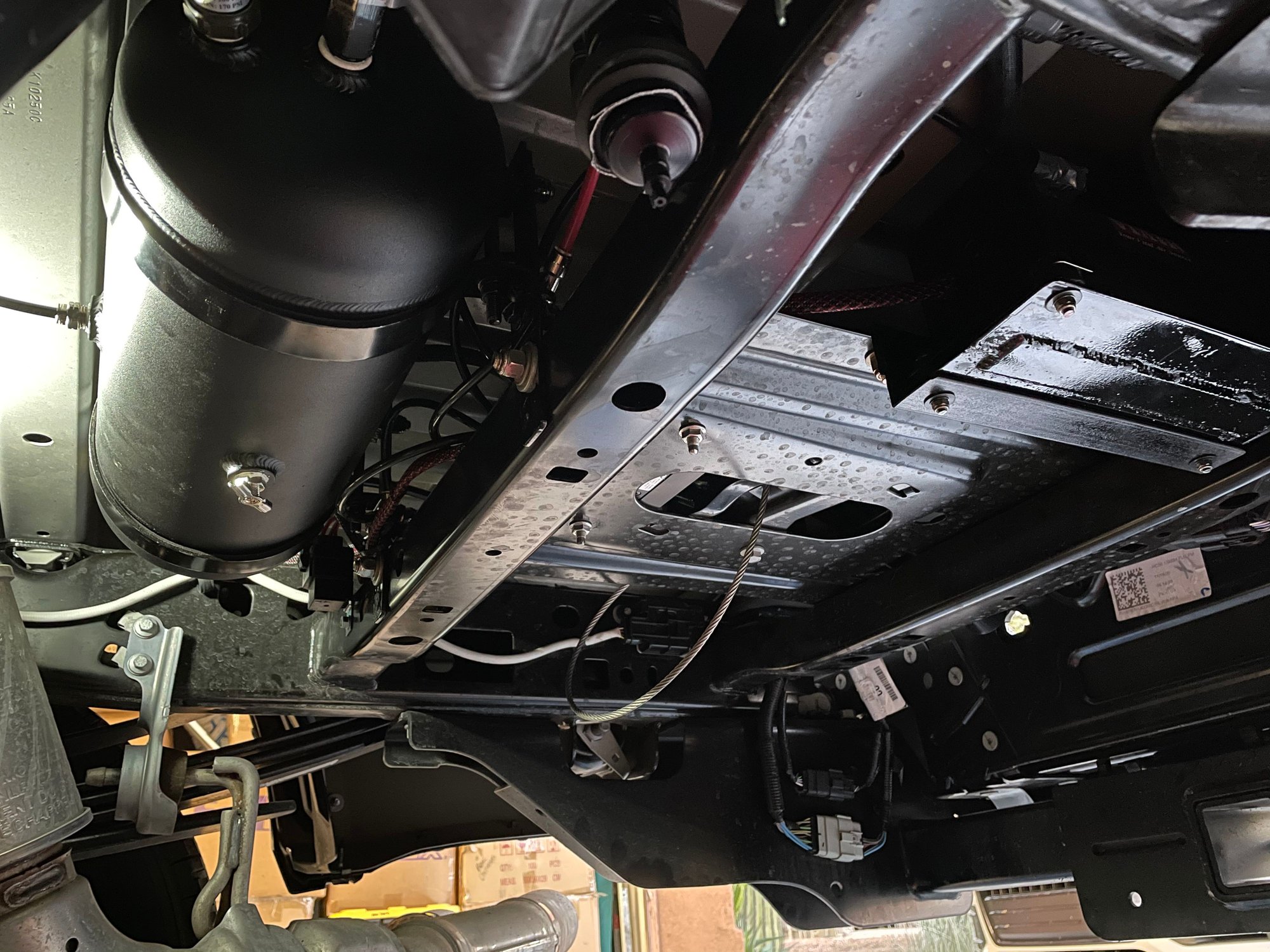

I drilled and tapped the frame rail for my viair compressor. This is the 480C compressor, one of their larger ones.

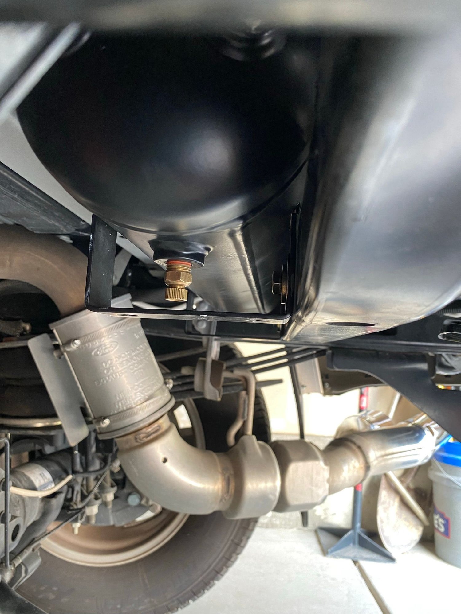

I made a mount out of two pieces of 1 inch angle iron and a 4 inch plate. Bolted to the drivers side spare steel mount. Hard to see in the picture.
I have since relocated the front airline to where the pressure switch was and mounted an air horn to the aluminum U channel in front of the tank.
