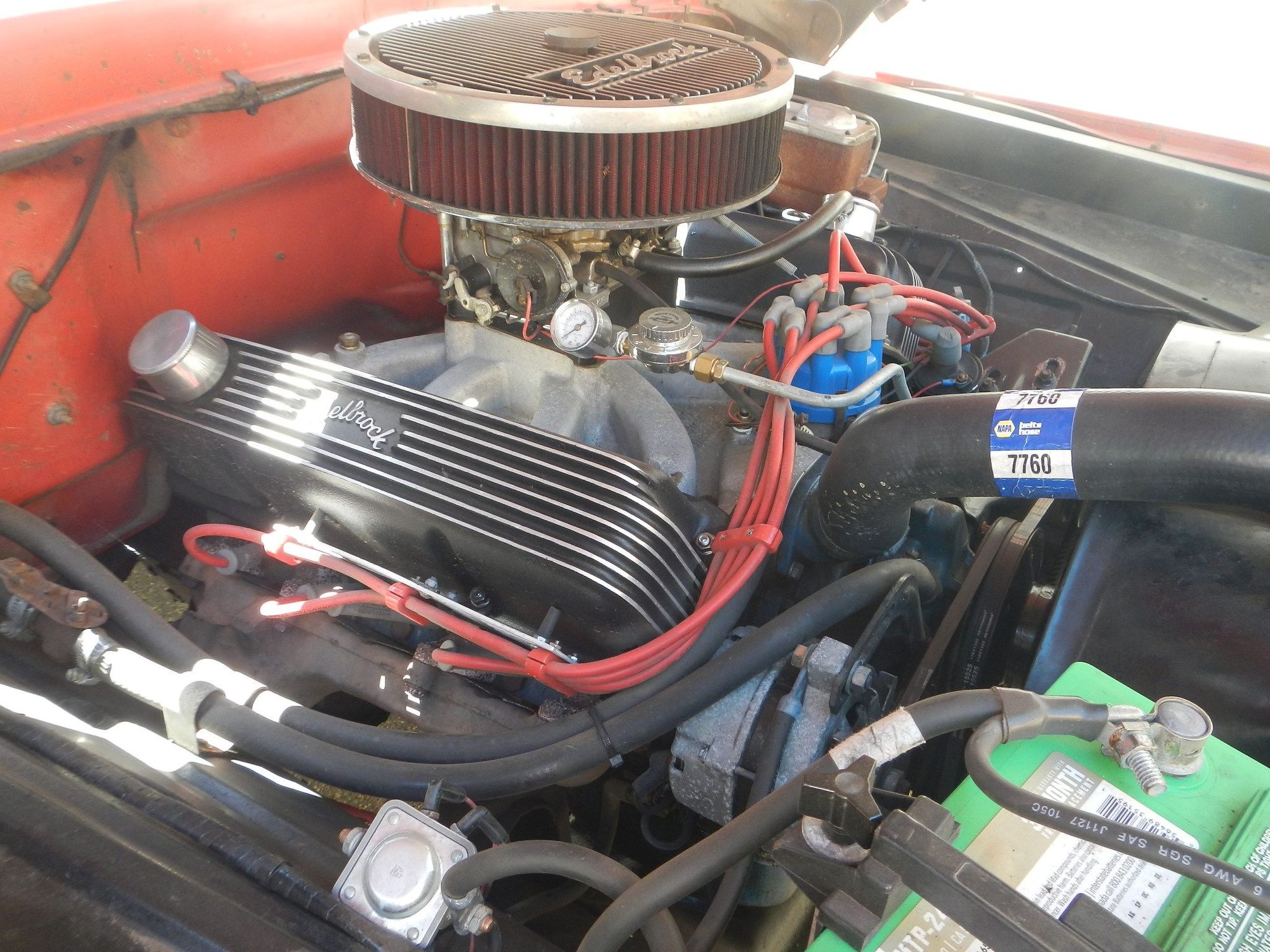

No smell of gas at the tailpipe and I don't have the spacer. After driving it about 40 miles today, when I got home and shut it off. I popped the hood and I could hear a noise in the carburetor like the the gas was boiling inside.

Can you post pics of your setup without the air cleaner to include both the back and front of the intake? Also what temps are you running at? and what type of gasket ate you running between the carb and intaj=ke? and how thick is it approx. ?

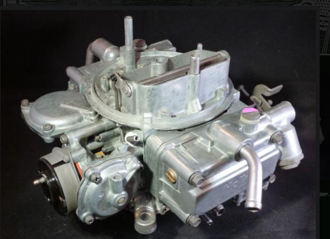

If you go with a 4160, I very strongly suggest not getting the cheaper version. It does not have a serviceable secondary metering block (you can't re-jet the rear two barrels). And it does not have "center hung" float bowls. They're side hung, and a pain in the butt. You can ID this carburetor by the external fuel line that goes from front to rear on the throttle lever side of the carburetor. A 4150 style Holley has center hung floats, separate fuel supply lines for each float bowl, and a serviceable secondary metering block. I like that carburetor.

I like my "guy on a budget" Holley's 4180C for 620 cfm
You get all the bells and whistles as the 4160 but can be built for $200 if you get a rebuild-able core for $100.
