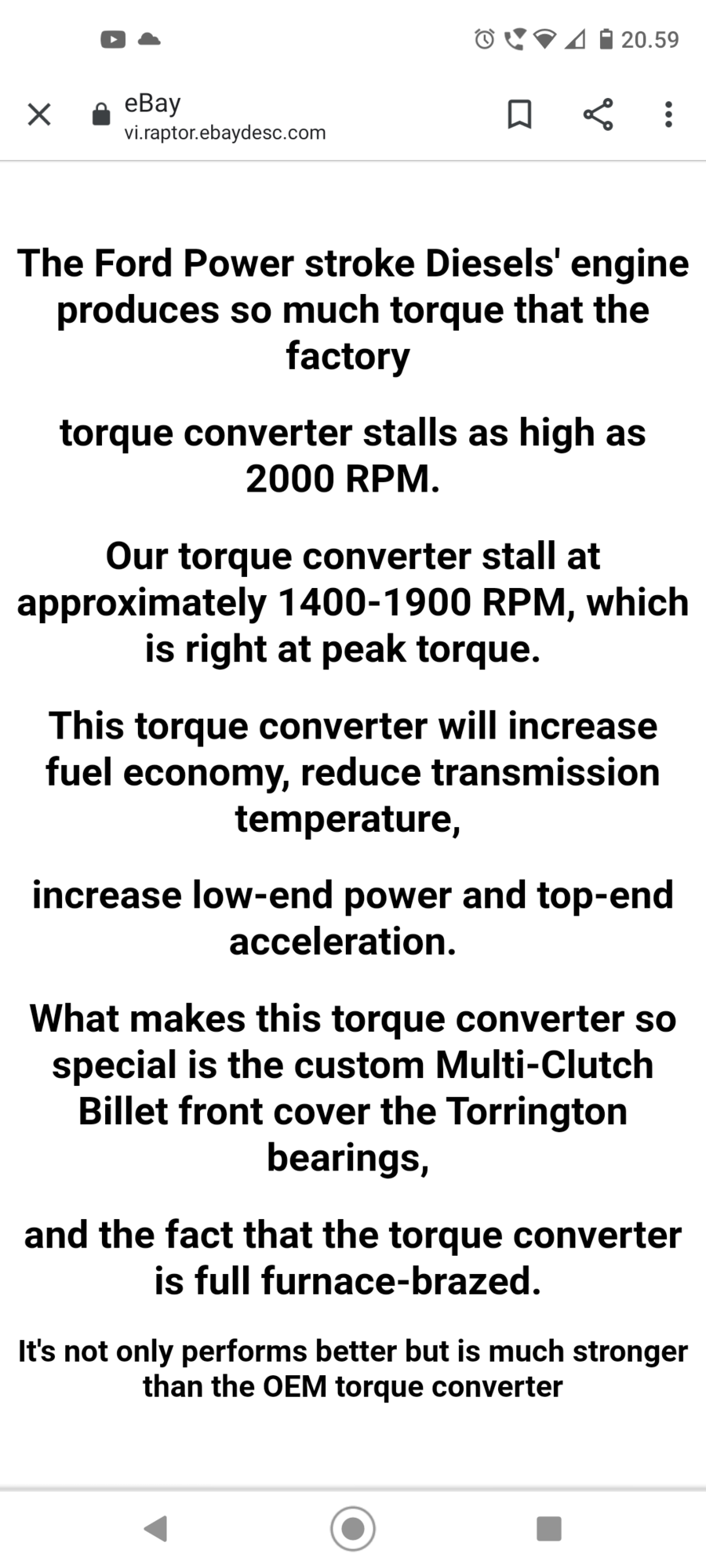

Low stall is good for Average Joe and even better for Average Joe who tows a lot!
7.3 has too high stall speed from the factory,even Mark K has said so.Factory stall is somewhere around 2000 rpm or more,lowering stall to match 1600rpm torque peak has many benewits.
If you dont believe me,believe Gale Banks:
https://official.bankspower.com/tech...g-stall-speed/
Marketing speach where i bought my extra low stall TC

The stock converter is WEAK. A good triple disc converter is an OBVIOUS difference. I’m not sure how ‘stall’ is measured, but when you put a good TC in one of these trucks, you better have your foot on the brake or it’s gonna MOVE when you drop it in gear.
Gale Banks is a master marketer - f’ing genius actually. He’s made millions as a result. I think he’s created a strong brand with mostly good products, but beware of the hype...
This has to do with how many rpm it takes to make the 2 internal fans run 1:1(close to it anyhow). They will ‘slip’ up to a point. Normally folks will describe brake stall when using the term, meaning how far can they make the TC slip until they can’t hold it with the brakes any longer or the engine rpm stops going up even though the wheels aren’t moving. The slip creates heat, a lot of it at the max stall point. So moving the stall point lower could help keep the trans cooler, but these trucks end up in lockup during normal tow conditions anyhow (lockup negates any stall discussion).
My race car can brake stall to 5000rpm. The TC was custom made to get me into the sweet spot of the power band.
One caveat on the 7.3 lower stall… the trend has been for people to go with bigger turbos and injectors effectively moving their powerband up in rpm. With the power coming on at a higher rpm the lower stall wouldn’t be optimal in my opinion. That’s why I added that as tracking point on the turbo matrix.
Agree with you here. The guy can market anything. Smart with engines? Absolutely. But even smarter in sales!
The points he makes in the TC sales pitch are valid though.
