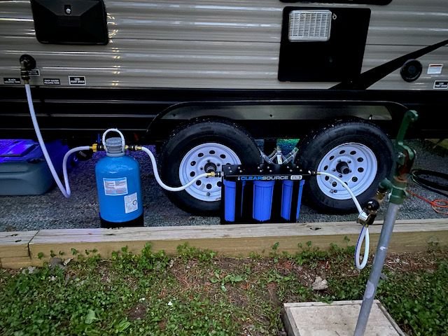

Last year I switched over from the cheap Camco inline filters for a more robust 3 stage water filter system from Clearsource. The Ultra system uses a 5 micron rust filter, then a 0.5 micron carbon filter, and then finally a 0.2 micron filter (although they recently changed the 0.2 micron filter over to a "Virusguard" filter). Anyway, after doing this we have been happy just drinking from the faucet with this set up. When I was backpacking I drank water filtered through a single, small 0.2 micron filter and it served me fine (and I have collected some water from some pretty nasty places...), and this system is no different. However, for kicks, and because we will be traveling much more soon, I also added in an On the Go double water softener this year. Besides this, I use good quality food grade hoses. I will likely pick up an under the sink filter that uses ceramic filtration sometime before we start traveling too...
For water that goes into the fresh water tank, I have a bottle of Purogene (chlorine dioxide) that is good for cleaning the lines and the tanks with, and can also add in small amounts to the entire fresh water tank when filling to help clean the water. (If anyone has ever used Aqua Mira while backpacking, this is the same stuff.)

Tap water around here is so good I don't filter at all. If I was travelling to unknown places, I'd probably start worrying about it. That three stage filter system @chadstickpoindexter has is really nice, and I'm sure it does a great job.

All I can say is WOW !!
You should be able to drink water out of a mud puddle with that setup !!
