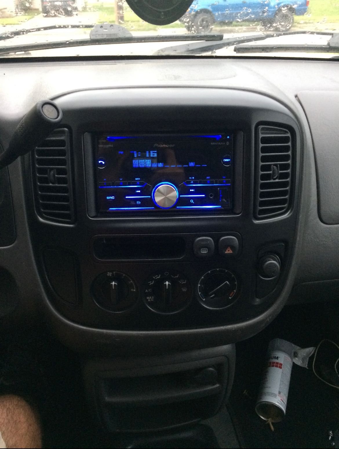

We swapped for a touch screen double din in my son’s 04’

It’s actually very simple & he purchased a very nice Sony from Walmart. We have a car audio shop near us, but they couldn’t touch Walmart’s prices. He bought the stereo, the install kit, (4)
5-1/4” Kicker speakers for the doors, & a 10” sub w/enclosure & amp for the rear. The head unit even came with a backup camera that we mounted above the license plate. The only issue we ran into was with the backup camera, since his Escape has a positive ground for the backup lights. We had to wire in a relay to make it work

Also, I just remembered, we started out first with a double din Pioneer, but it wasn’t touch screen. But this gave him the opportunity to paint the bezel because it was silver & wasn’t looking to good. The nice thing about the Sony too is that it has Apple Car Play which syncs to his IPhone
