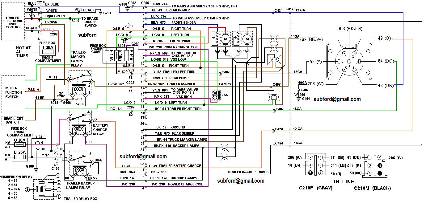

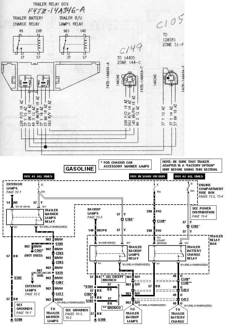

So I am trying to wire up a trailer brake in my 93 F350 CC SWB 7.5. I found this relay box, it is a Ford labeled box, it is attached to the engine compartment fuse/relay box. I have searched all over and looked through the owners manual etc. I cannot find the identification of these 2 relays. Or for that matter the purpose of the additional relay junction. Please see pictures ((2nd picture is the relay box in question), thanks for the help!!

They are stock Relays that come with the Trailer/Tow factory package.
One is the Trailer Battery Charge Relay and the other is the Trailer Backup lamp Relay.
Attachment 279711

So it would have nothing to do with trailer brakes wiring? Thanks for the replies!!

No, the brake wiring should be wired like the diagram below.
Attachment 277956
