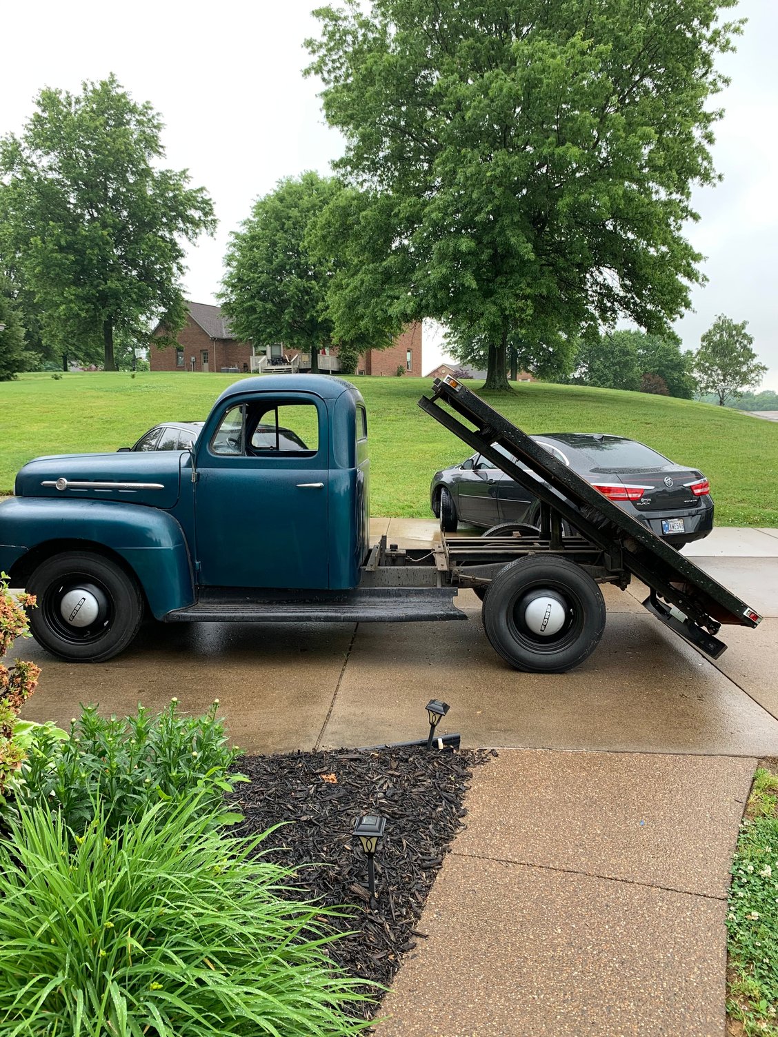

My dad gave me his ‘52 F3. It had been sitting since 2016. Finally have it running and mechanically safe to drive. However, I lose the brake lights and turn signals when I turn on the headlights. I promised my dad I would leave it as a 6v system, I replaced light switch, flasher, and checked the wiring. Since turn signals were a dealership option, I haven’t been able to find a diagram that includes the turn signal. Turn signal switch is a Napa 900, Any suggestions?

Good looking rig.
