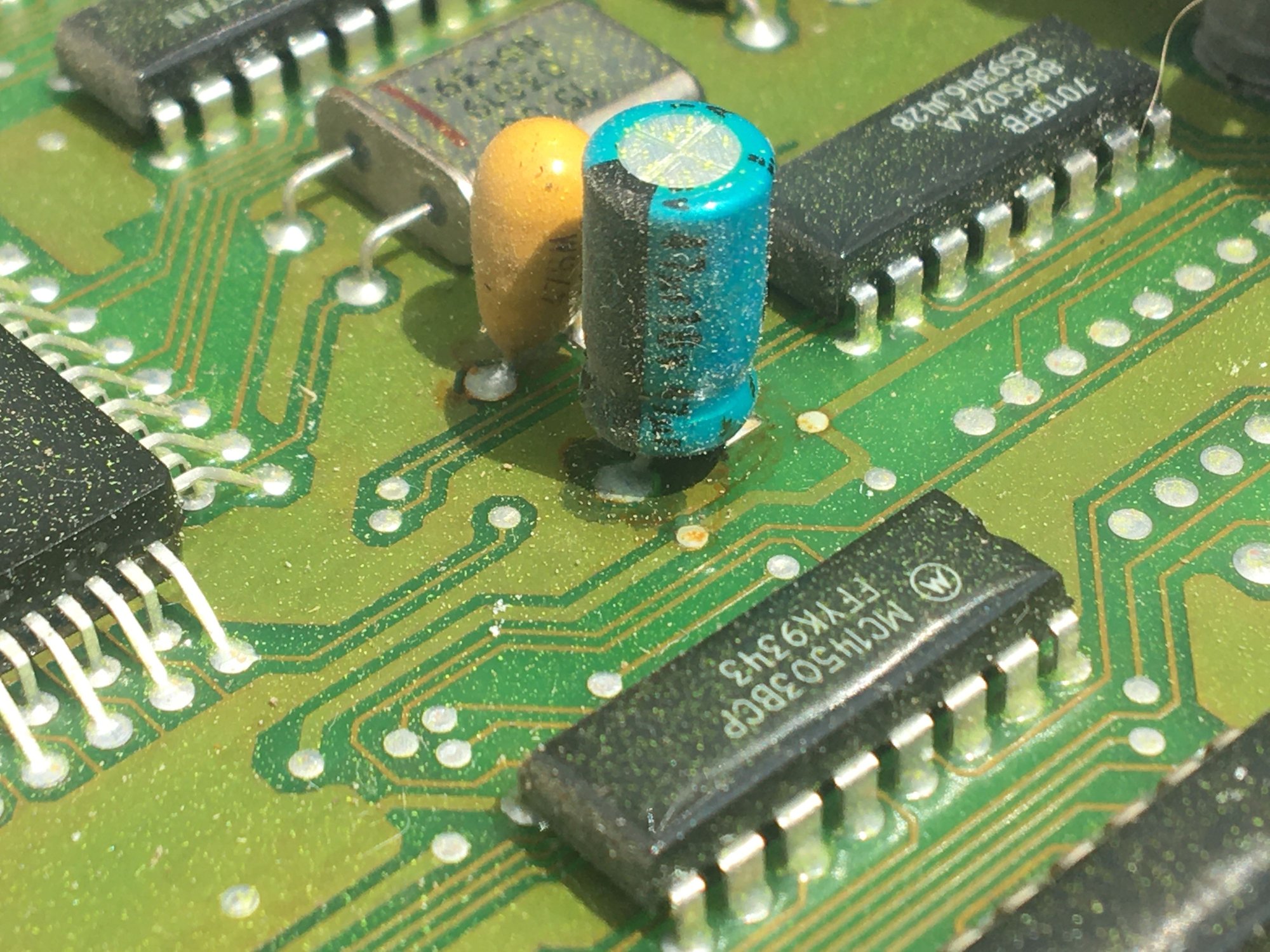

Well I pulled the PCM out today and opened it up and it looks like 2 of the 3 capacitors are leaking. The rest of it appears to be in pretty good shape though. Any suggestions on what should I do? Should I buy a rebuilt one, have this one rebuilt, see if an electronics repair place will work on it?

The advantage to buying one locally (O'Riley Autozone) is they come with a one year warranty and if you have an issue you can get it replaced overnight instead of shipping one off $ and waiting for ? to get it back. There are no new ones and Ford uses the Cordone reconditioned ones to sell just like O' Riley. I have bought three from them for various trucks and never had an issue. Good luck on whatever you decide to do. Sandy

thanks Sandy, I’m glad to hear that. I kinda hate to give up the original for a core seeing how it’s in pretty good shape, though I have no real reason to keep it

You could replace the capacitors yourself if your positive that's the problem .

I have no electrical experience and would be afraid of messing something up

The core charge for the PCM ranges from $50.00 to $80.00. I kept mine for about two week first time and when I was convinced the new one worked I took it back for my credit. Changing the capacitors as mentioned is doable but it's not like a diy soldering two wires together. You could always keep the core and try it and have a spare, but the rebuilt PCM's are not going anywhere as the demand continues to increase as our trucks age. With the warranty you get the replacement free for a year with immediate turn around so the spare is not necessary for a year. 2dwoods has a valid point.

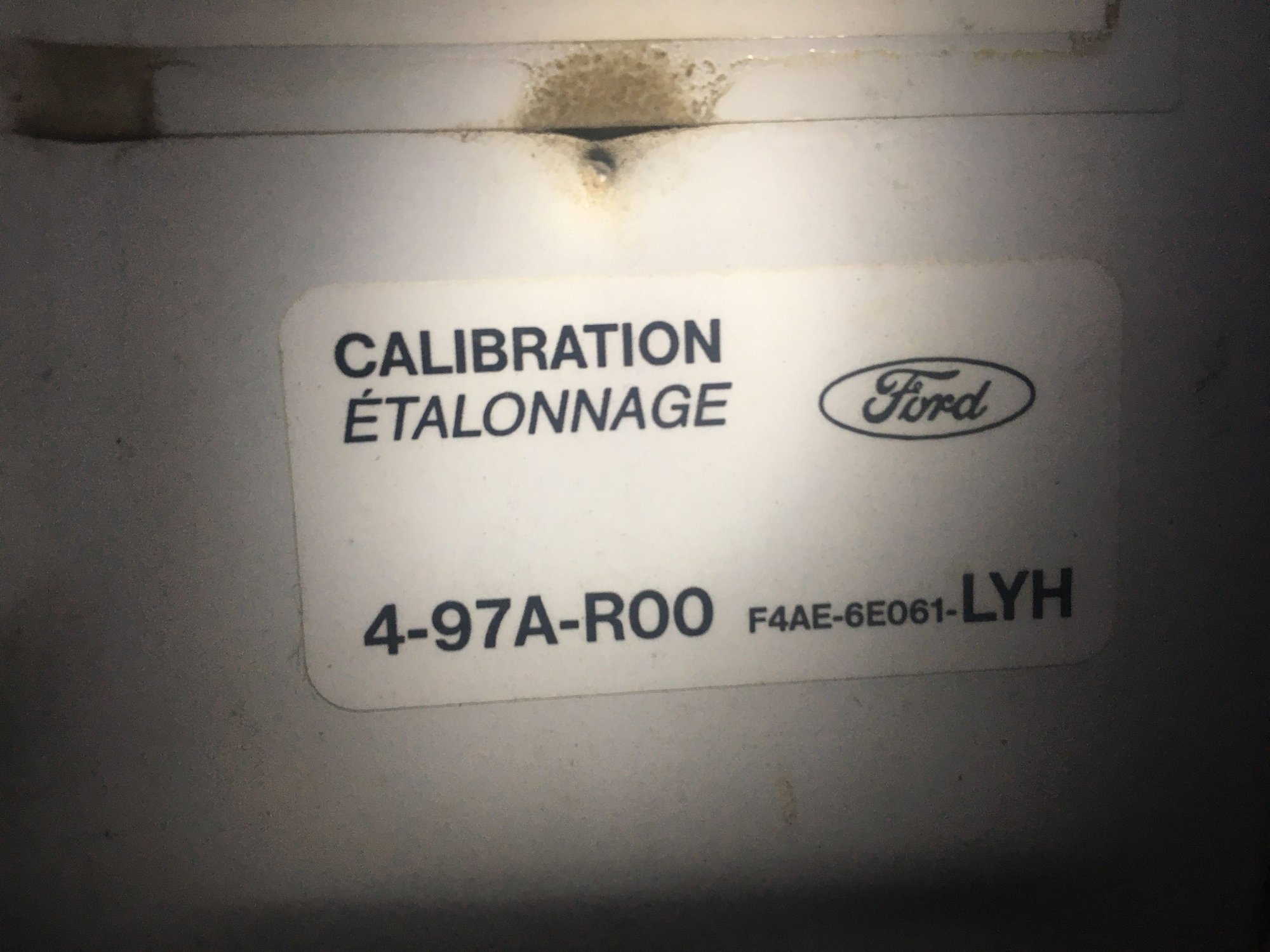

If you post your calibration code, on driver side B pillar, our GURU's, can tell you if the one you have is correct, or it may have been changed out before you acquired the truck.

Old Jul 2, 2021 | 08:59 PM

nope far from it, just what I have leaned from our Guru's, never assume its original, if your assuming then assume its bad until tested, subford, usually has this info, the calibration code, helps him know where to look, and tells which specific PCM is needed for said, truck, and with these trucks getting long in the tooth, and people just getting you dont know for sure if PCM is original or they had issues.
