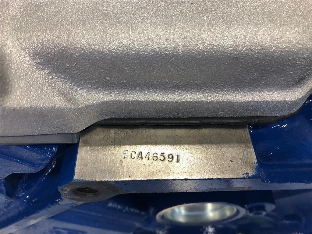

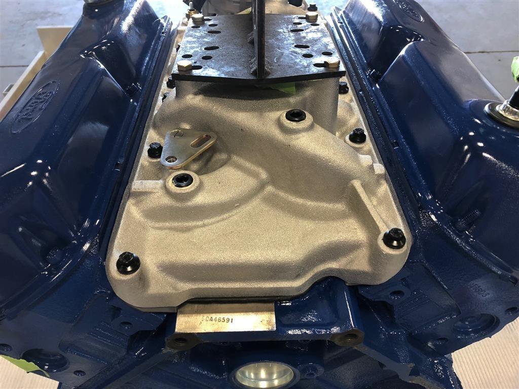

Are you thinking bow tie were they stamped the number to match the VIN and where "numbers matching" came from.
I dont think Ford or any of the other big 4 did that back in the day.
Dave, Ford did do it sometimes...but there doesn't seem to any consistency to it. When I cleaned up the 302 in my 1984, I found the last 8 digits of the VIN stamped in the back of the block (flat surface behind the intake manifold). See pics below. I'm not the only one that has found this...the topic does come up once in a while as guys with other trucks and cars have found this same stamping with the VIN. I also had a 1985 F150 with a 302, and it did not have this stamping. However, if you read on here and other forums you will find that other people have found the VIN stamped here from time to time.
Old Jul 2, 2021 | 06:23 AM
FuzzFace2's Avatar
FuzzFace2
Posts: 30,915
Likes: 4,123
From: Angier, NC
Thanks for the info
I guess because it was not done on all engines I never heard of it
Thanks again
Dave. ----
