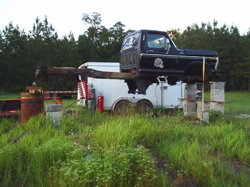

It's not necessarily a mall crawler or pavement princess, I still use it offroad for light duty I just haven't really needed the 4 wheel drive where I've gone. And it's still a work in progress, I didn't use it much last year because there was an electrical gremlin I was chasing down. Got that sorted and it runs fine now just not the 4x4. Which thanks to you I have a plan of how to fix. This is how she sits currently.

Yes that thing is a big beast, with a lot of lift. What size are those rims? 16", 17", 18"? I would say some 40"s would fill the fenderwell just fine, 42" are getting way up there.
