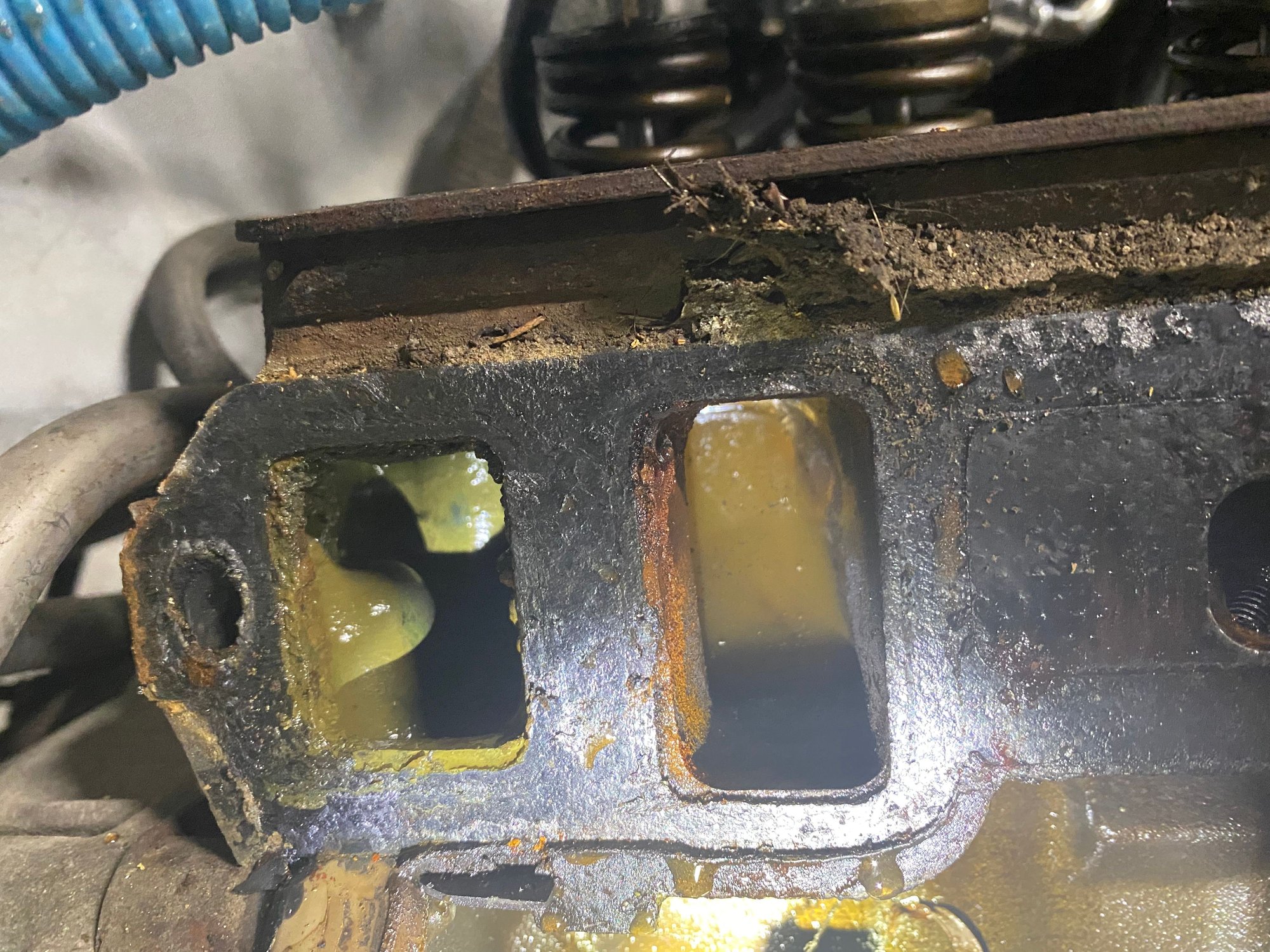

Here ya go. Found the problem. Full of coolant.
Boy I would guess so! Now gotta figure out why on the teardown. Good luck!

By the way the springs look in the picture, both valves are closed. Are you sure the coolant in the port isnt from pulling the manifold off of the engine? If the valve is closed, there shouldn't be any in the cylinder, just sitting on the back side of the valve.
i would use a rag and soak that up, and then see if the valve is closed.

That’s what I am thinking. I’m going to try and get all the fluid out before I pull the head.
