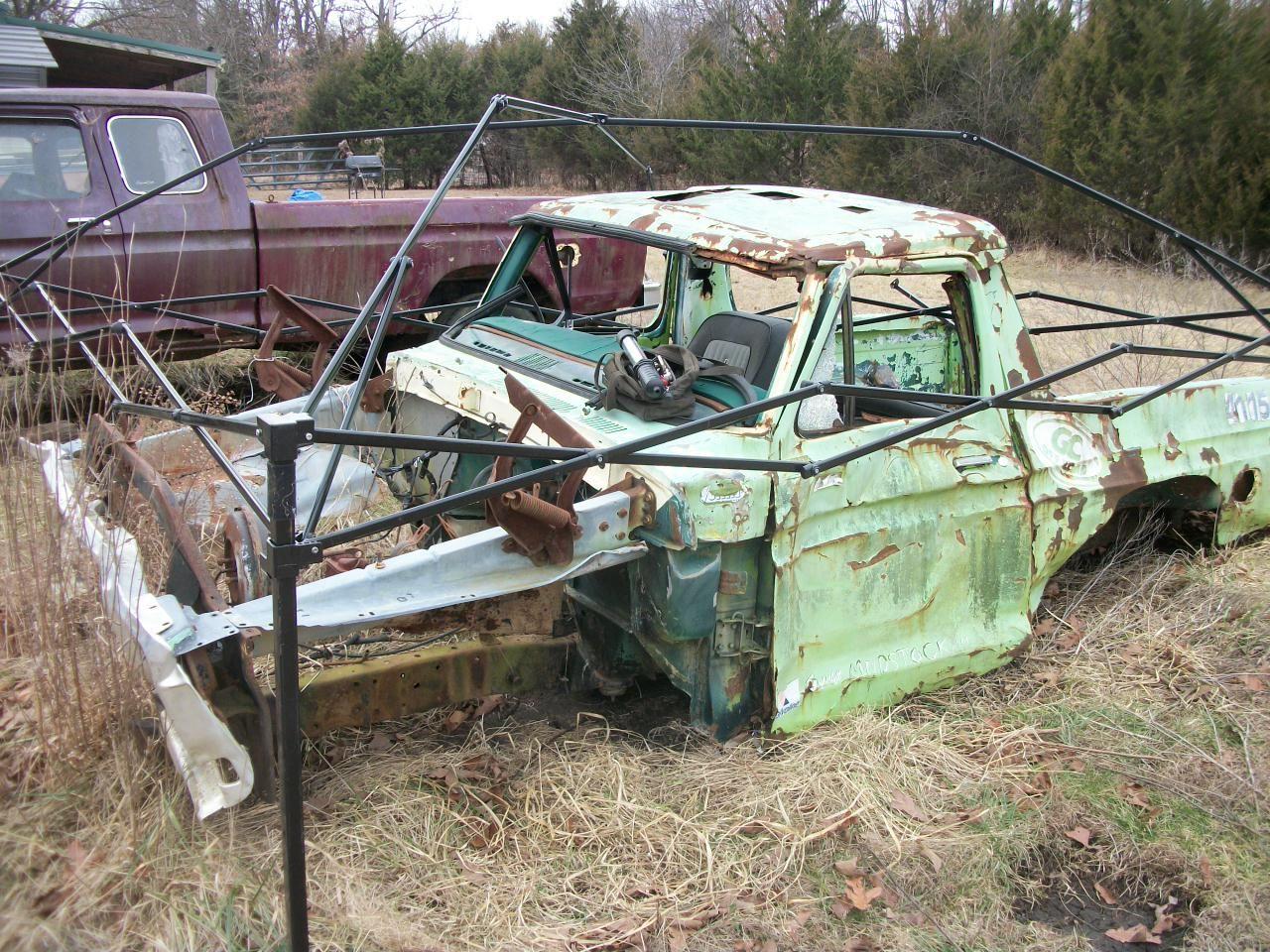

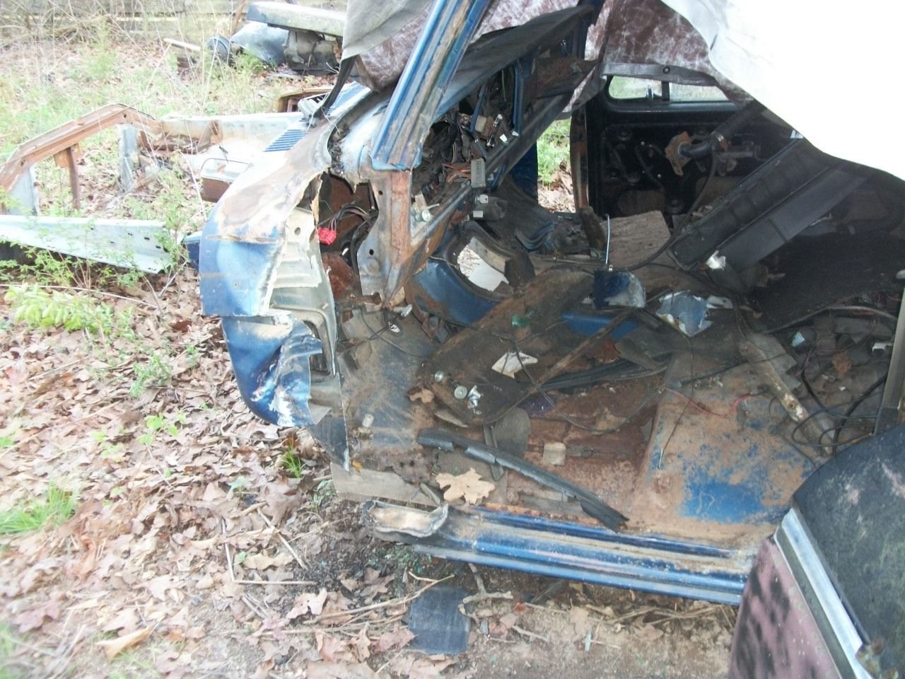

I once cut out some parts of # 020500 (door hinge mount area) and man was it a bear. I mean all kinds of panels connect in that area.
I have a couple of spare 79 parts Bronco's, (both with a/c) and a spare 79 parts cab (no a/c)...so if you need a certain off shaped patch panel cut out of the firewall/cowl, PM me. For the most part they are the same on the front end.
