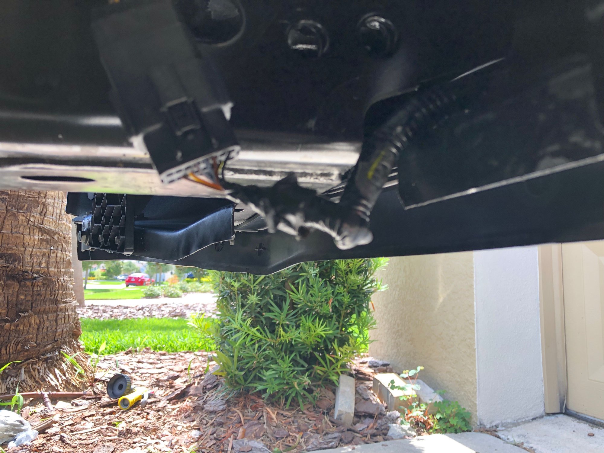

There is a wire harness behind the lower valance, not too far off center to the drivers side. I swapped my 4 mile long stock valance for the tremor valance yesterday and the new tremor valance just barely covers this harness. The harness is actually held in place by one of the screws from the valance.
Im wondering if anyone else who has swapped to the tremor valance did any relocating of this harness?

Just zip tie it up in there someplace to get it out of the way. You can unclip that connection from the frame and raise it up a bit and secure it higher.
