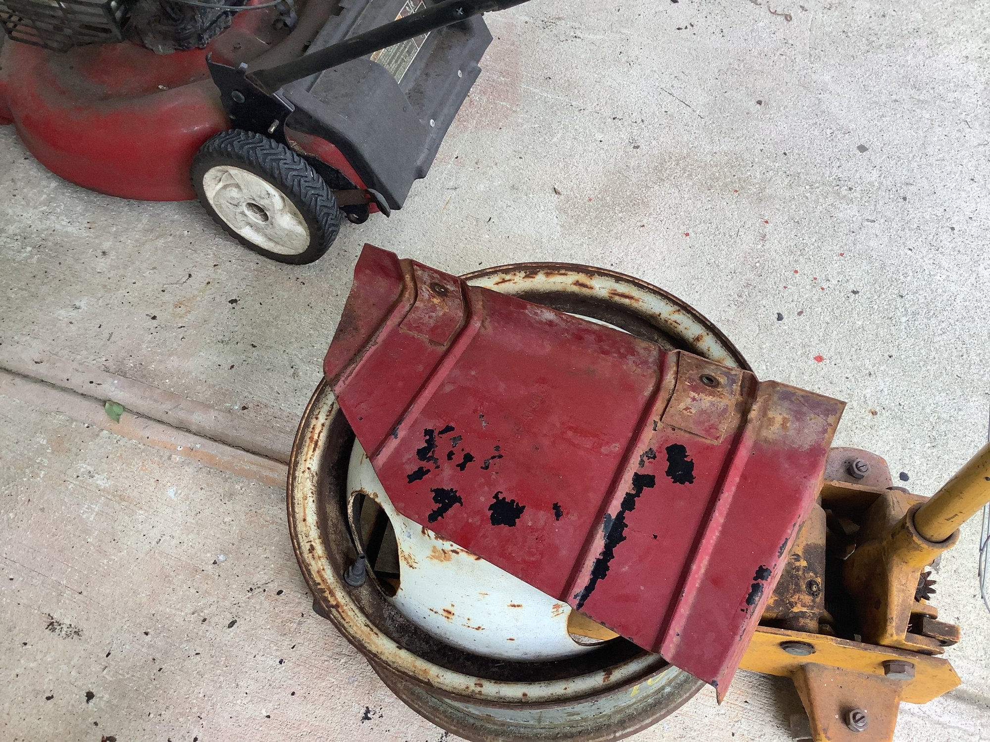

This was in the toolbox of my 1982 F350 Cab and Chassis when I bought it. Any idea where this piece goes?

Are there any Ford markings or stamped numbers on it?

Its not something I have seen on my 81 F100's, flare side or style side trucks, and I have had both stripped to nothing.
But a WAG a 2nd battery tray?
Bolts to the left inner fender or radiator support?
Being your truck was a CC what bed was on the back?
Maybe from it?
Dave ----

Does the color match the truck?

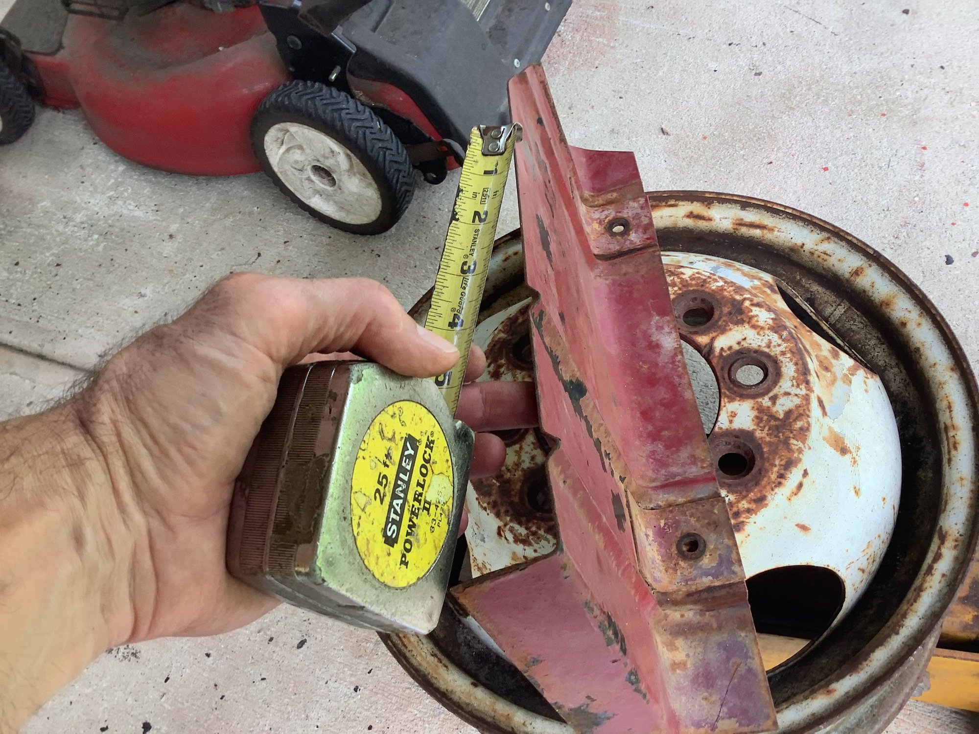

The only mark is the sequence: D9TA-9B100-AA. Same color as truck.

Didn't some setups with the bed mounted storage compartments have a shield in front of them? Or in front of an auxillary gas tank?

I googled that part ID code. Midship fuel tank heat shield.
Dave, I too thought battery tray part
