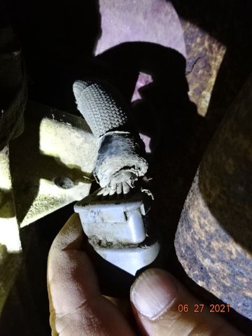

Checked plug and it looks just fine.Figured Ford parts would out of the question with the age of vehicle. Will check the local dealers and see what's up. Thought there might be a better,upgraded aftermarket one available.
