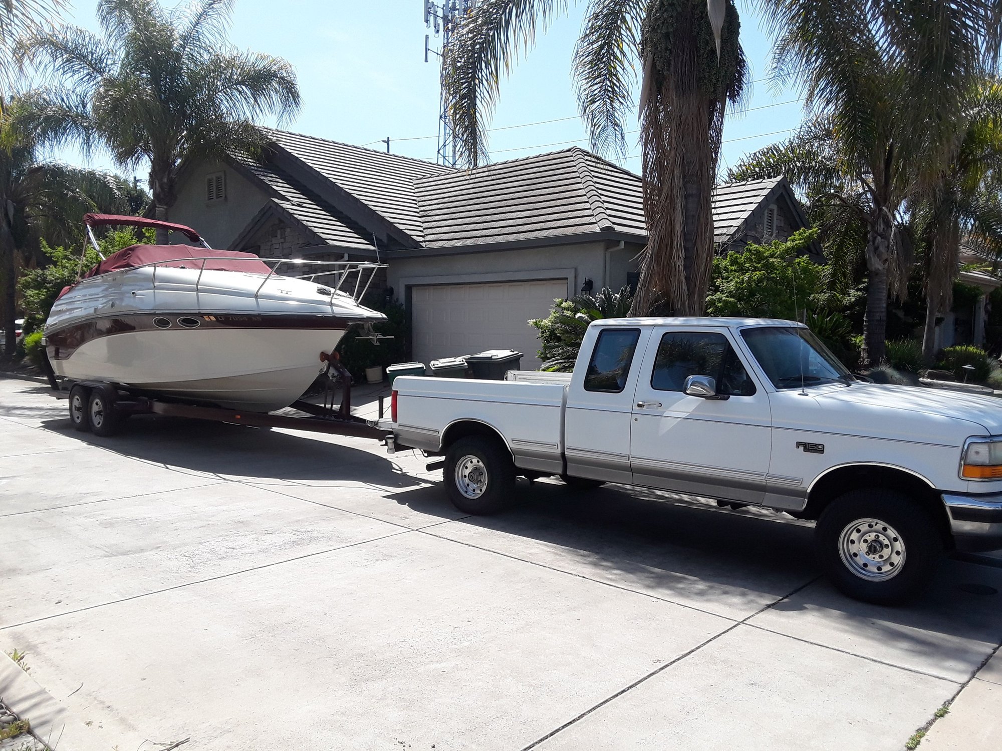

I have a 95 F150 4x4, e4OD, 4x4 5.8l...trans recently serviced and all runs great. It's pretty stock and the PO never did any serious towing or hauling. I plan to tow a large boat (7k lbs) just a few times a year over a small mountain range to the coast in Northern Ca....about 150 miles.
Is the stock trans cooler sufficient? What recomendations to keep the Old E4OD happy? I understand they don't like heat...so again, am I fine with the stock cooler? Suggestions? Advice?
The truck tows the boat fine the 20 to 30 miles each way from The marina to the house or to the shop for service.
Thanks,
Dan
