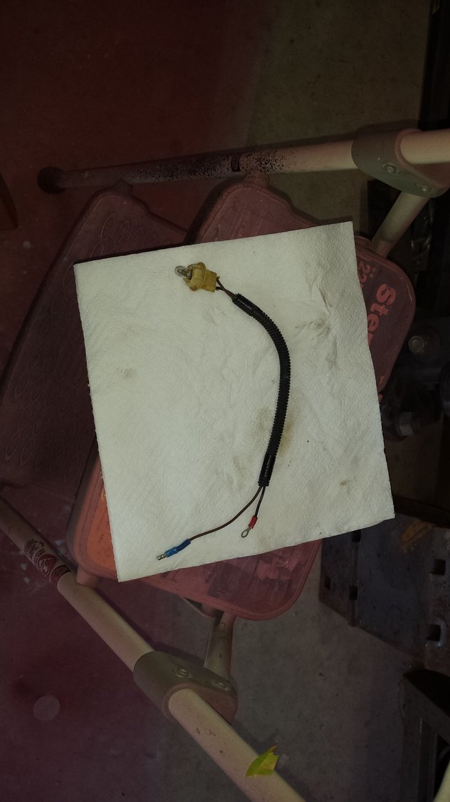

I got a 7 way connector and a brake controller at a garage sale a few years ago, and since I'm repairing the taillights I figured now was the best time to install them.
Garage sale find.
[The box that had the brake controller and the 7 way outlet in it cost less than $20]

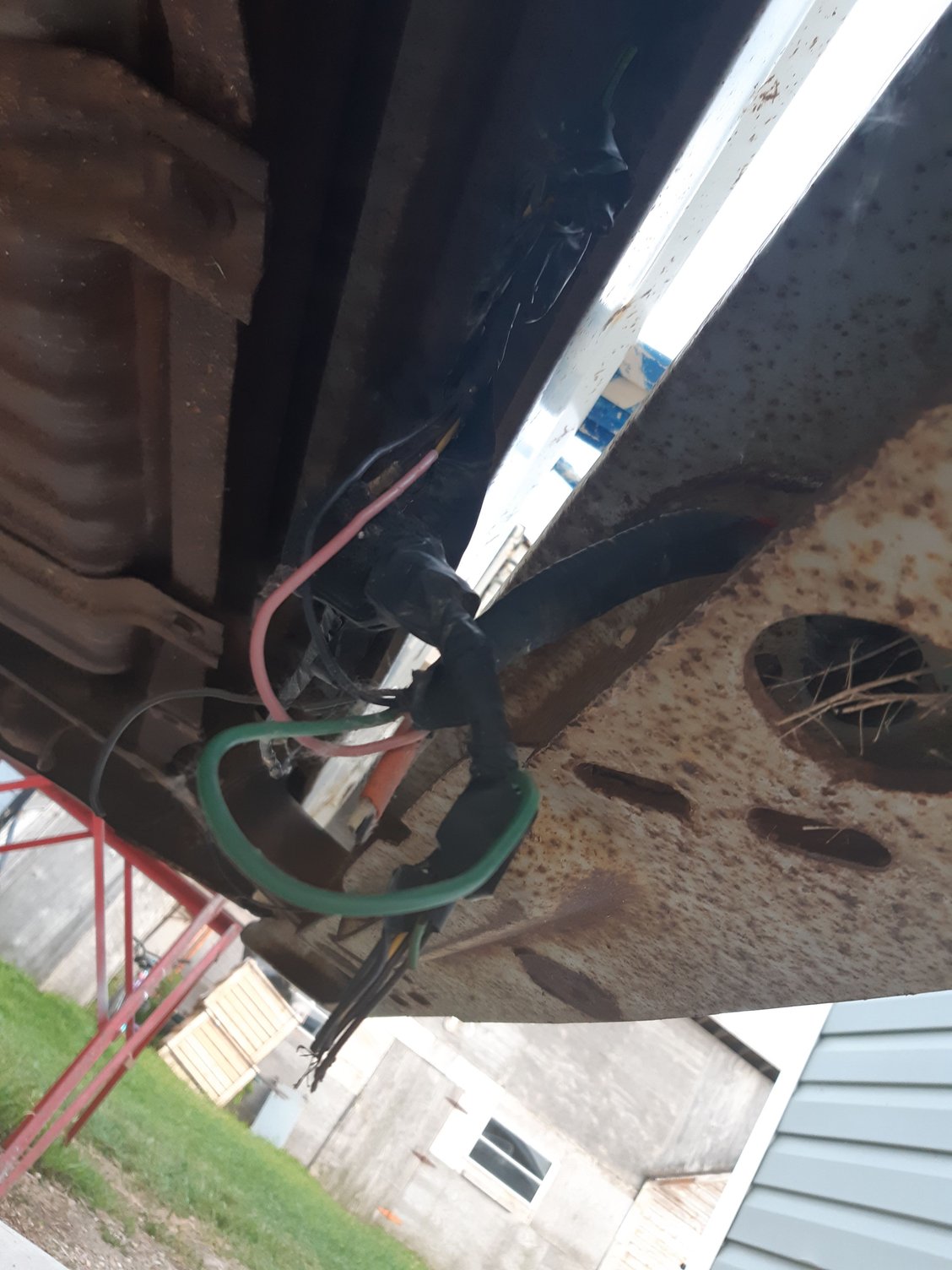

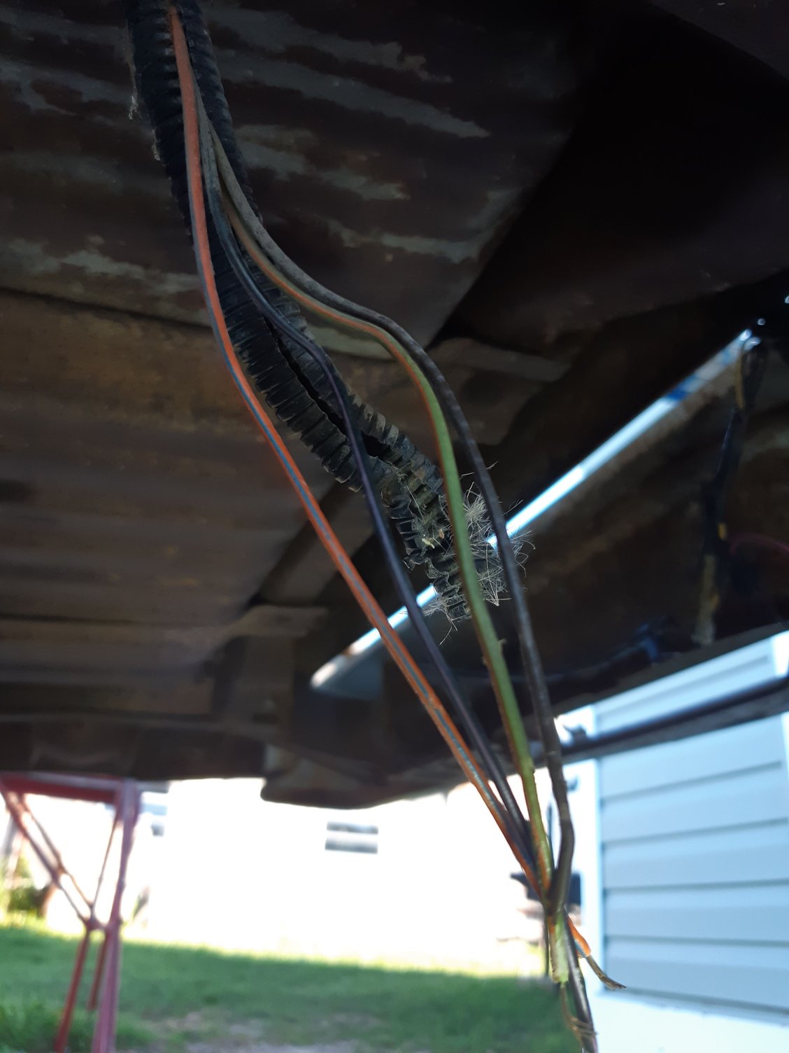

Edit: There are only four wires going to the back of the truck, and they're all broken.
Can I just wire the trailer lights into the taillight circuit?
(I know I have to run more wires for the brakes, but I'm not sure about the taillights and signal lights.)

Yes you can wire the trailer lights in to the trucks taill lights.
Depending were the tail kight wires are broken there is a harness plug at the left rear corner that connects the frame rail harness to the tail light harness.
Etrailer.com and others sell a Tee harness the gose between the 2 harnesses and the wires from the Tee go to the 7way plug.
That is how my truck is wired and I pulled wires for the electric brakes and power to charge a battery in a travel trailer.

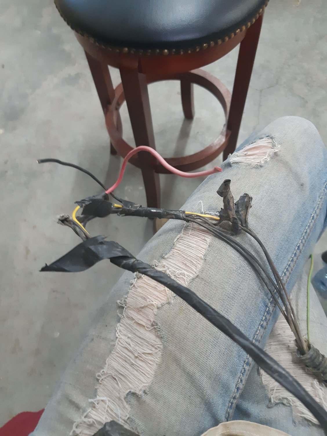

Here's the four wires coming off of the truck,
That's all folks
The rest of the wires are tangled up inside the bumper, I'm honestly considering pulling them all out and fixing it on the bench.
Although that's probably the smartest way to do it, since it looks like I'll be battling against a lot of corroded wires.

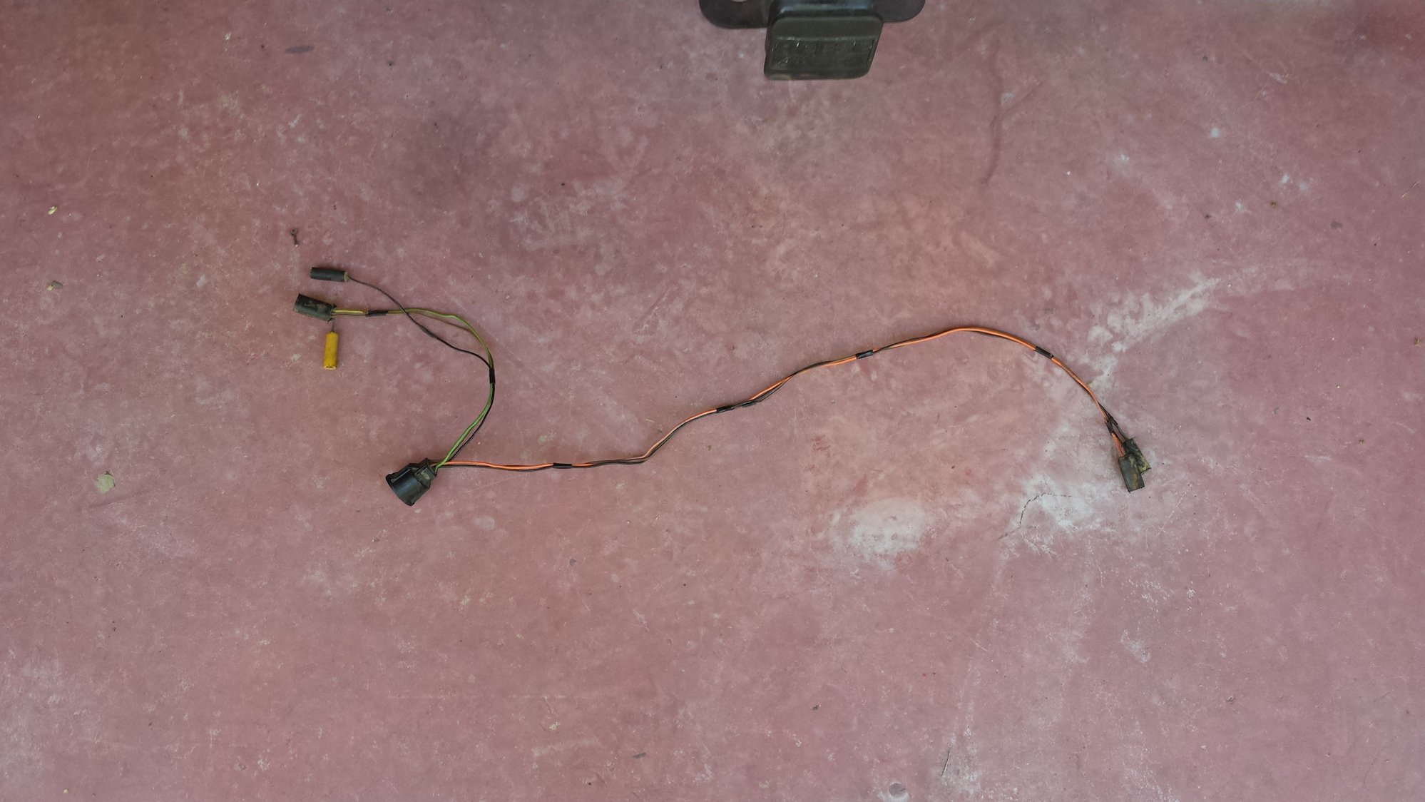

kind of a mess honestly.

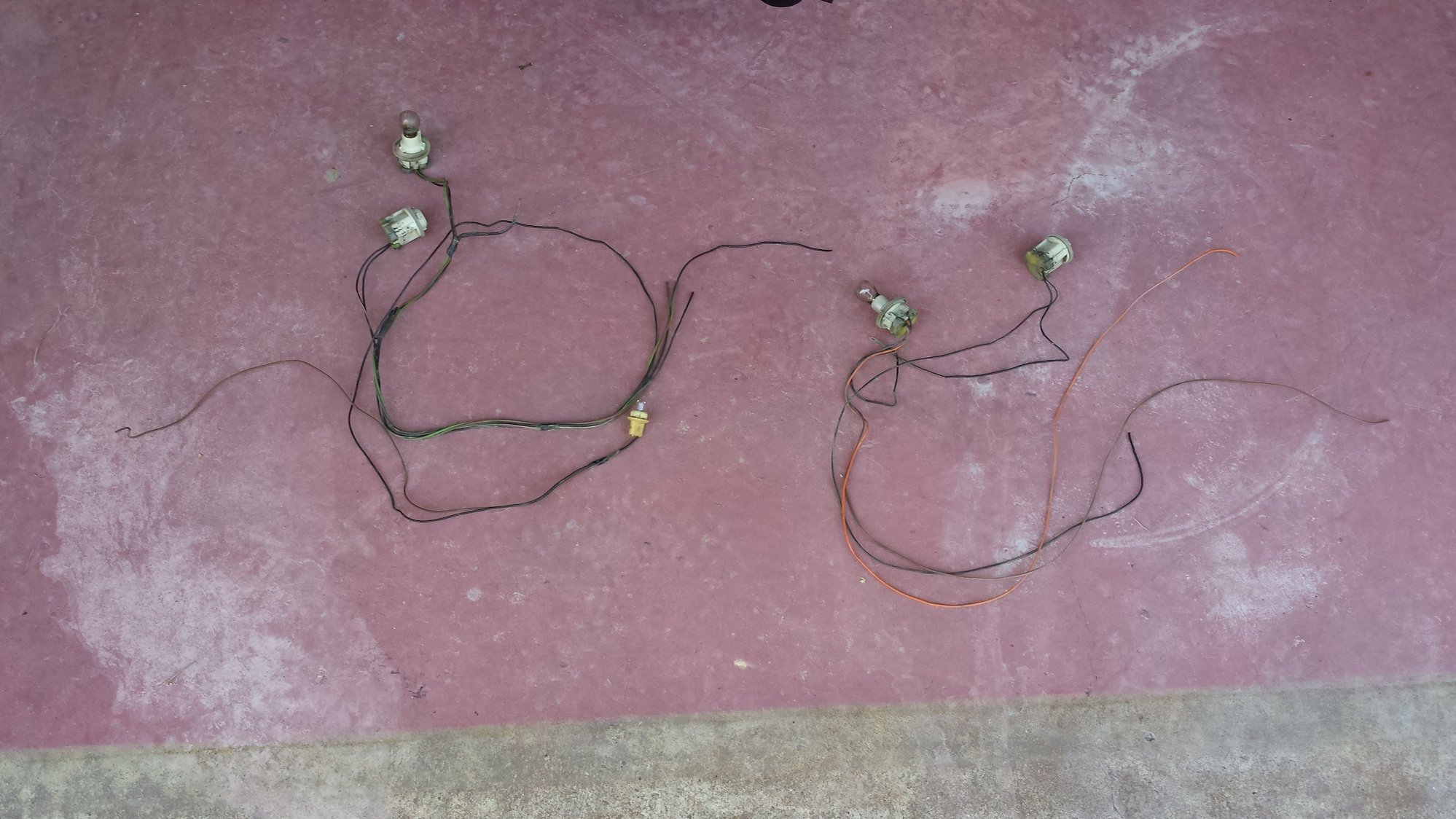

So I pulled out the old trailer plug and the rest of the taillight wiring harness, since it's way easier to Find issues when I'm not covered in spiders.
These weren't even connected to anything, they were just covered in electrical tape.
A complete mess.
So I cleaned it up and got it ready to to splice in the trailer plug.
Cleaned up and labeled, ready to be put back in the truck.
Sometime later tonight or tomorrow I'll put it back in the truck and install the trailer plug.

If you have not already installed it plug it in to the main harness and see if the lights work.
This way you will not need to pull it back out to fix it.
My truck is a little different as I dont have a ground wire for the tail lights and when testing before install I did not have lights but had power?
Once I grounded the lights I was good.
I had to make a tail light harness for my flare side from a style side as I did not have anything for the flare side.
