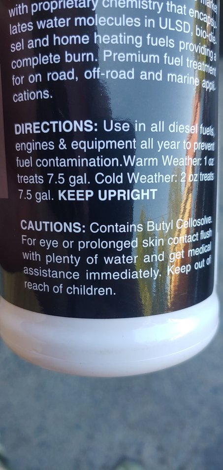

Did he treat at the 1:500 ratio or the 1:1000? What was used to measure the amount of K100D and what amount was it? What's a couple "drops" of water? From an eye dropper or from a bottle of water? I wasn't there to see how he did it.
The new bottles, which is the combination of their regular use additive and their long term additive, is marked with "Treat water at 1:1 ratio." From what I was told by the company, that does not include the initial dose to treat the fuel.
One new bottle of the two I have. I understand your scepticism here as no one knows what amount of moisture will be present in the fuel they buy when they fill up at the station of their choice.
This is the older bottle after they combined the two diesel additives into one to be called K100D+.
So with that being said, I don't think K100 makes claims that it will handle any amount of water with a normal dose of it. When a test is done like this, it shows how the water will be absorbed in the fuel and handled. In real life, there's always the unknown and risks.
