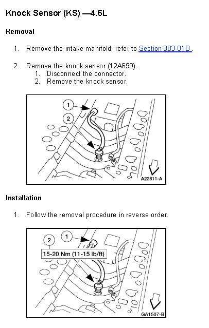

I would suspect the knock sensor of not doing it job.

I might be remembering something never said but aren't the knock sensors R&R-able without removing the intake? I know it would be one **** kicking deal but maybe somewhat easier than pulling the intake.
I might be thinking of the CHT sensor though...............
