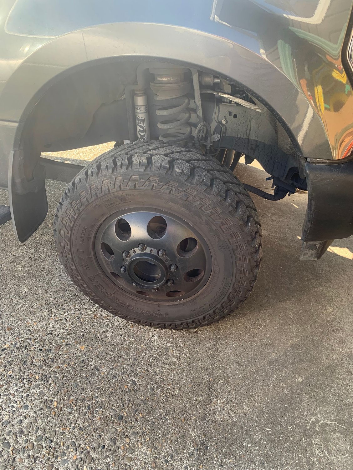

Can a guy put taller tires on like 255/80-17's on a stockish rim without going to 20's or 22's? I think that would fill the wheel wells up and give it a lifted look as long as there is enough space between the duals....

I put 255/80-17 on my 2018 work great but still leaves a lot of open wheel well.

I was hoping to be able to get a 265/65/17 on mine but I think theyll be too wide. What wheel is that you are running?

American racing stock size pull a 35’ grand design 5th wheel no issue.

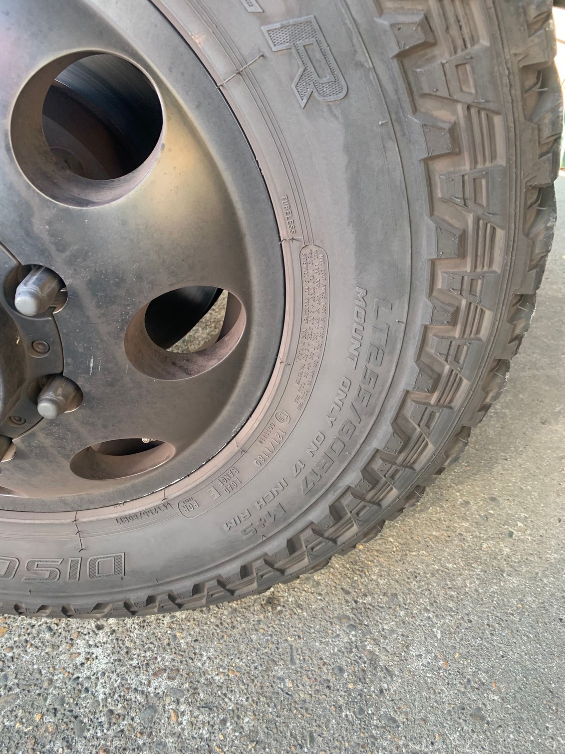

Stock wheel is 17"X6.5" and Cooper Tires specs the tire I posted above (255/80-17) for rims 6.5" to 9" wide.

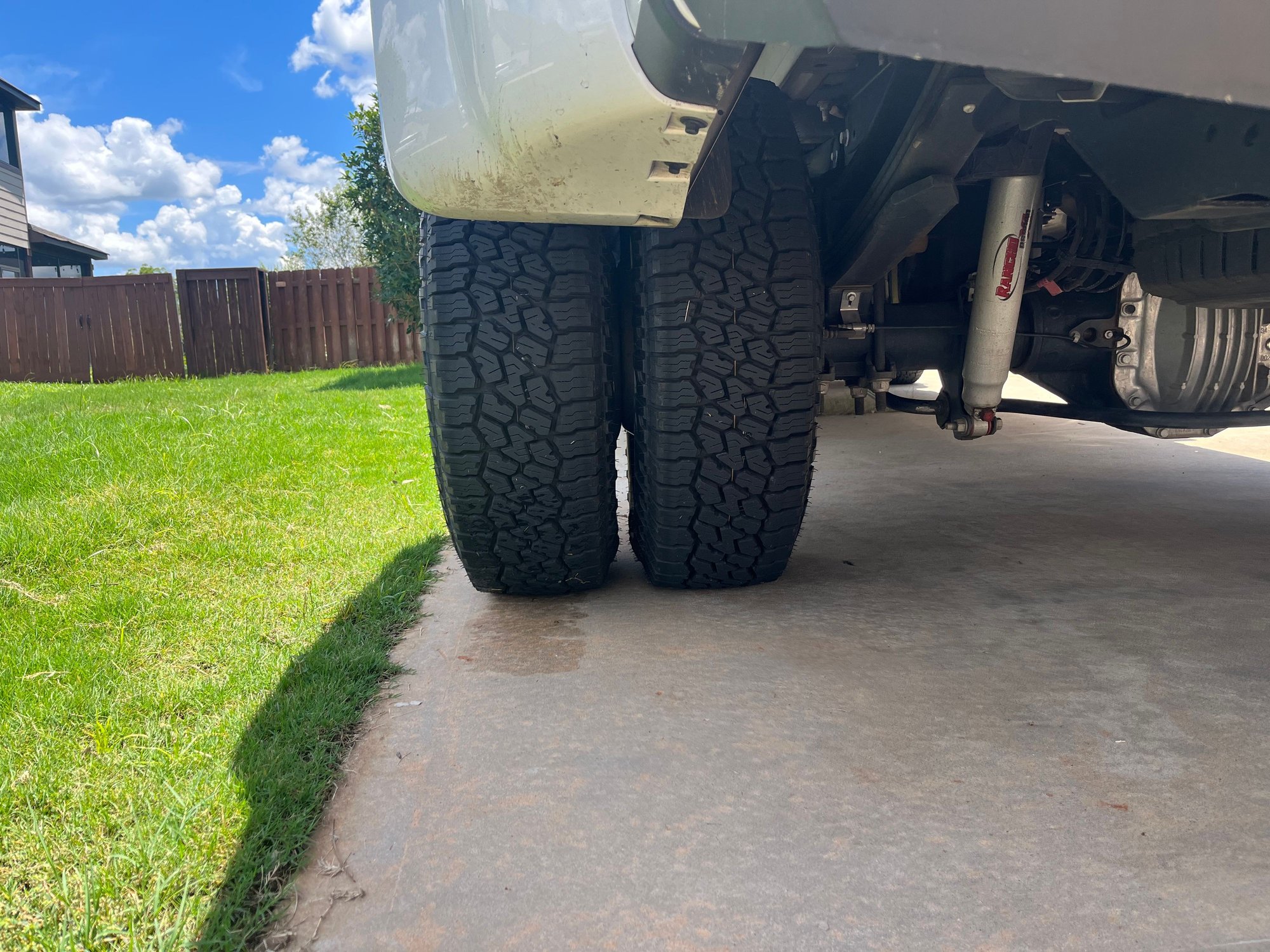

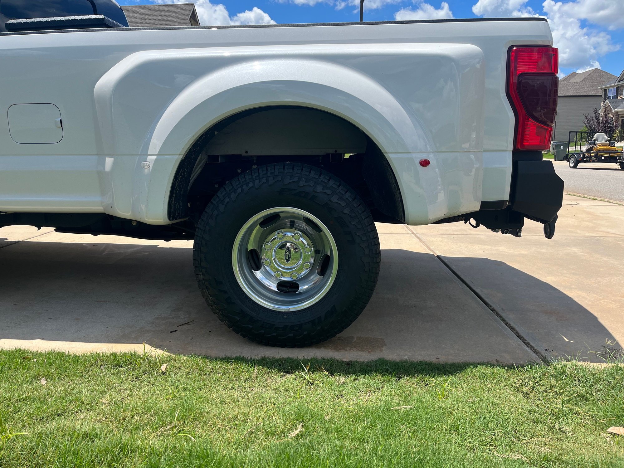

255/80R17 on stock wheels/suspension
