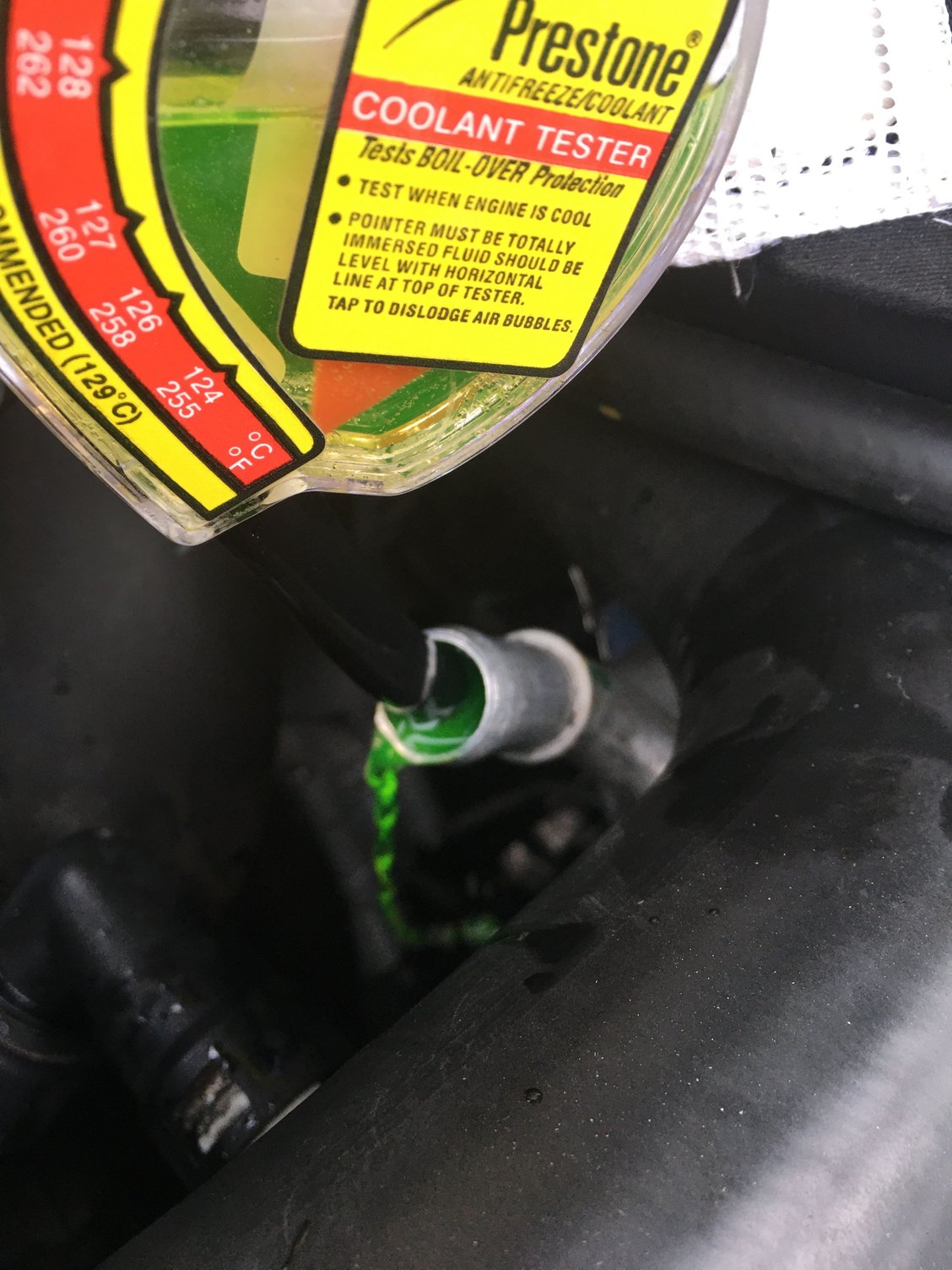

Correct Coolant??
So, had to do a hydroboost replacement (leaking P/S fluid) and I disconnected the primary coolant reservoir and the turbo intercooler (secondary coolant system).
Problem is the primary coolant looked to be the correct orange coolant, but my intercooler seemed to have the regular green coolant in it although the manual
says both systems should have orange. I've never done any coolant maintenance on this truck so it had to come from the factory this way.
Should I just top off the green coolant in the secondary or drain it completely and put the orange in it??

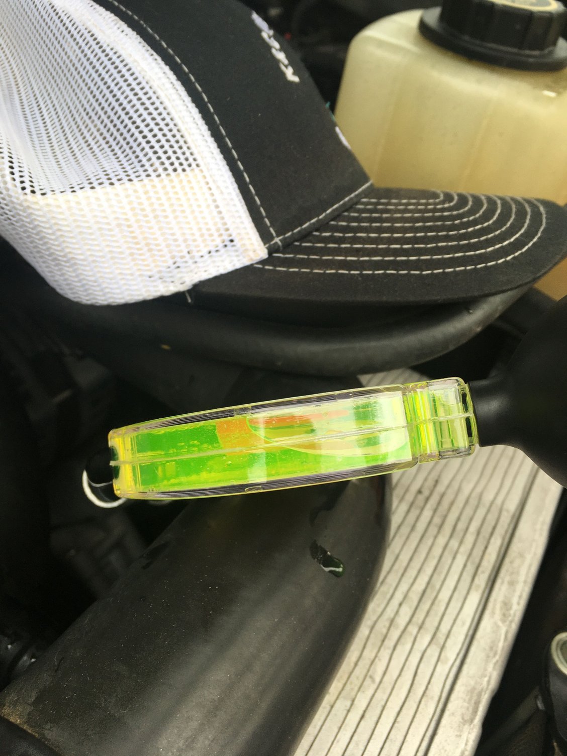

If it was dealer serviced then it should have the current yellow in it. For clarification here is what yellow looks like.
Ah, maybe that's it. I've got secondary pink and then the good primary.

Here is what I have…so it’s Ford Yellow??? The primary looked more orange, so I used orange there, am I in trouble??

From: Brentwood,CA
That's Ford Yellow aka POAT coolant.
