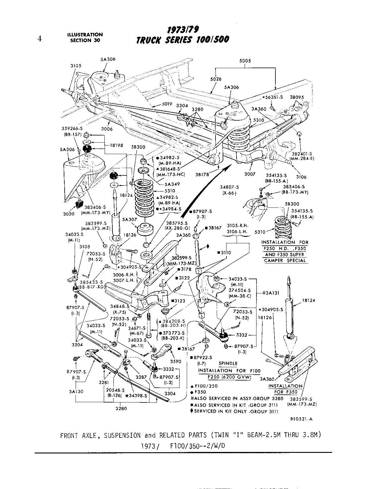

Lower shock bracket that mounts to the radius arm.
C5TZ18126A .. Right Front Lower Shock Absorber Mounting Bracket / Obsolete.
Fits: 1965/72 F100/250 2WD / 1973/79 F100/350 2WD

Based on everything I've seen on this part number, the C5TZ18127A and C5TZ18126A are for '66 through '73 2WD F100 and F250, and supposedly changed for '74.
