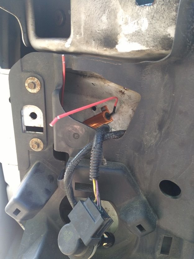

I mounted the resistors on the metal rad support and spliced the wires into the harness, I didn't use the clips included with the kit I soldered the wires. A note to anybody doing this, if you use the included splice connectors put them as far back from the connector as possible, the light connectors are already a tight fit through the openings in the support so there can't be any extra bulk in this area.
So once I figured out the correct wires to attach the load resistors it's all working as expected. Another odd thing here is that the turn/running light wiring was slightly different on each side, I had to attach the resistor to the center and outside wire on the left but it was the two outside wires on the right side.

I discovered I had made a mistake on the front turn/running lights, it appears my earlier claim that there were wiring differences between the L and R housings was not correct, the turns use the two outside wires on both sides. Believe it or not I was using a multimeter to probe the wires to find which ones to use, but I got a flashing signal on two different pairs so it took a little bit of experimentation to figure out.
