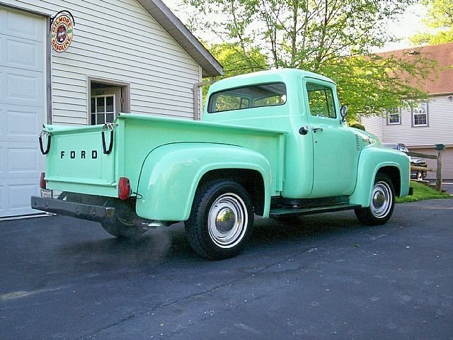

Sounds like good news. I can't answer you question about the clutch pedal but I do want to comment on your truck. That looks nice. I like the door art. And you must have been in an Independence Day parade. Nice!
Old Jul 6, 2021 | 09:41 AM
  #40
pagoda69's Avatar
pagoda69
Joined: Jun 2012
Posts: 79
From: cape cod/venice florida
Hi Abe, Yes, but that was the 4th of July two years ago! Two much vibration for this year's parade. This was a farm truck from Ohio. Very low mileage.

Love that truck!, Stunning. Where in MA? I am in Western MA near Great barrington in the Berkshires.
Old Jul 6, 2021 | 03:59 PM
  #42
pagoda69's Avatar
pagoda69
Joined: Jun 2012
Posts: 79
Hi 8pack,

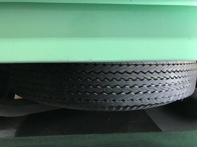

Thanks. I am about as far east in MA that one can get, Chatham. It is a great truck. Re-painted by the original owner about 40 years ago in its original Meadowmist Green. Paint is poor but looks OK from 5 feet or so. Still retains it's original interior. All original dated sheetmetal. No rust ever. No body damage ever. I took the original wheels and hubcaps off when I bought it. Still has the original spare tire. Pics with white walls are from the original owner, when I bought the truck.
