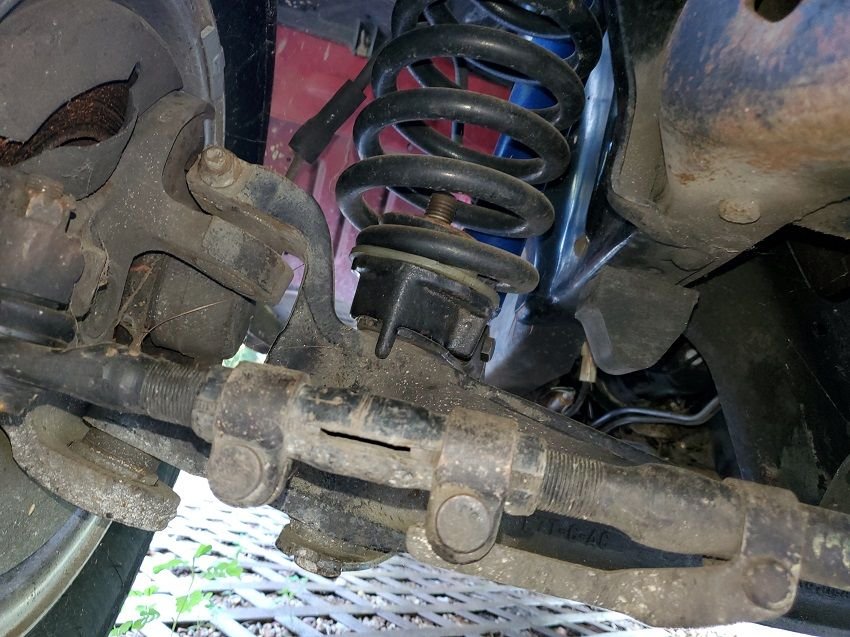

I happen to have my front anti-roll bar & components out right now while I do some things.
Nothing riveted, but I do wonder if the spring seats that sit on the radius arm has the end-link mounting tabs on non-bar equipped trucks.
Mine is an XLT with all the towing accouterments, but no helper springs. I've counted several trucks spring packs including a short bed 94 5.0 base model I own & they're the same number & size.

Well I answered my own question. No front bar, no tabs on the spring seat.

Everything you need for the front
Parts are left/right specific save for bar bushings/brackets.
