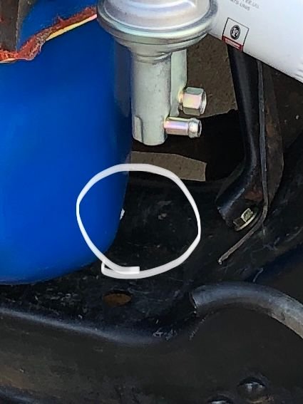

Posts: 155
Here’s a picture of what I’m talking about I had a aftermarket pan on there before and as you can see the drain plug is right next to the crossmember and i swapped that pan and put the factory one back on until I dropped the motor and crushed the damn pan

If you can't find one, alter the one you have by welding a thick piece of steel, where you need the drain to be. Then drill and tap a hole for the drain plug.
