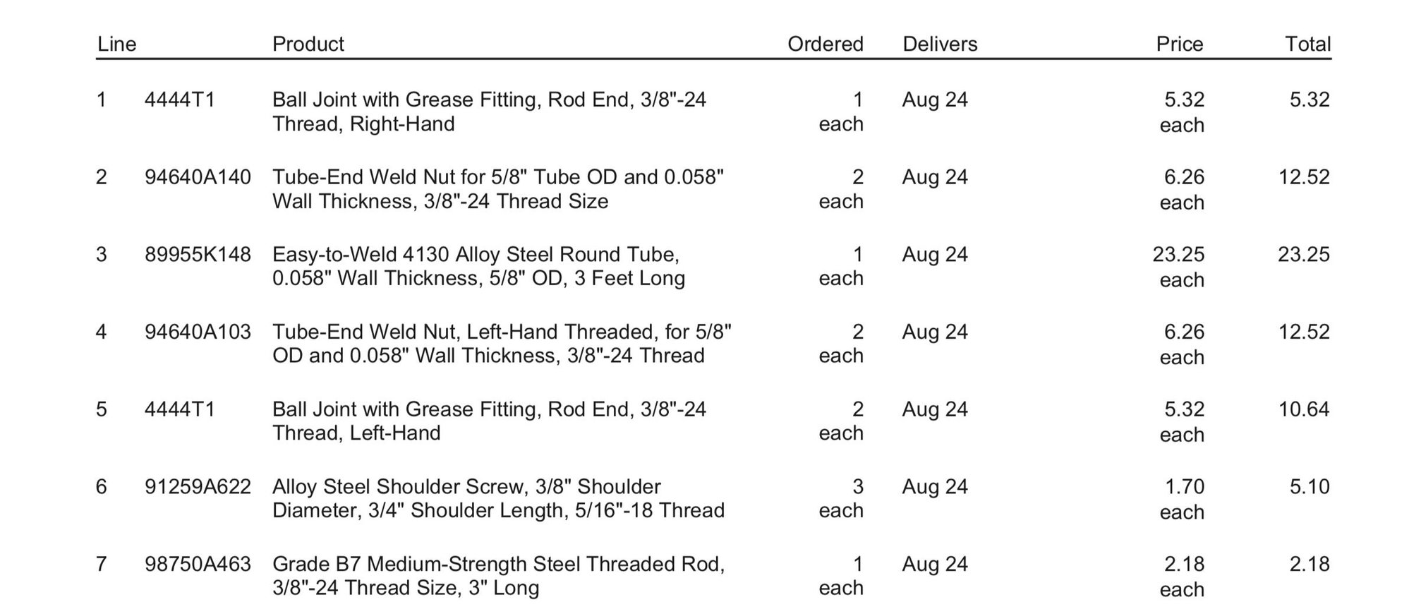

Here you go!
In addition, you will need four 3/8-24 nuts, two of which need to be left-hand thread. Those are the jam nuts that hold the ball joints in position. You’ll also need three 5/16-18 nylocks for the shoulder screws (I suppose they don’t have to be nylocks but that’s what I used).
Pretty simple project. The 3” threaded rod is what I used to replace the pointed sleeve that contacts the clutch fork on the original assembly. I ground it down to a rounded point by chucking it into a drill press and grinding it down with either a file or a grinder. I forget which; either would work. I originally planned to harden it with some heat and an oil quench but never did. Doesn’t seem to be any worse for the wear.
You’ll need to remove the pin in the z-bar, which will leave behind a nice 3/8” hole (if I recall correctly). The other hole that connects to the original rod was all wallowed out on my z-bar, so I welded it up and redrilled it out to 3/8”.
You will also need to open up the hole in the clutch rod seal where the rod enters the cab. I just chucked a Lyman case deburring tool into my hand drill and used that to scrape away the rubber and open the hole up. It’s about the right size to allow the 5/8” OD tubing to slide through it. I still put a bit of Sil Glyde on the rod to keep it from binding up too much.
