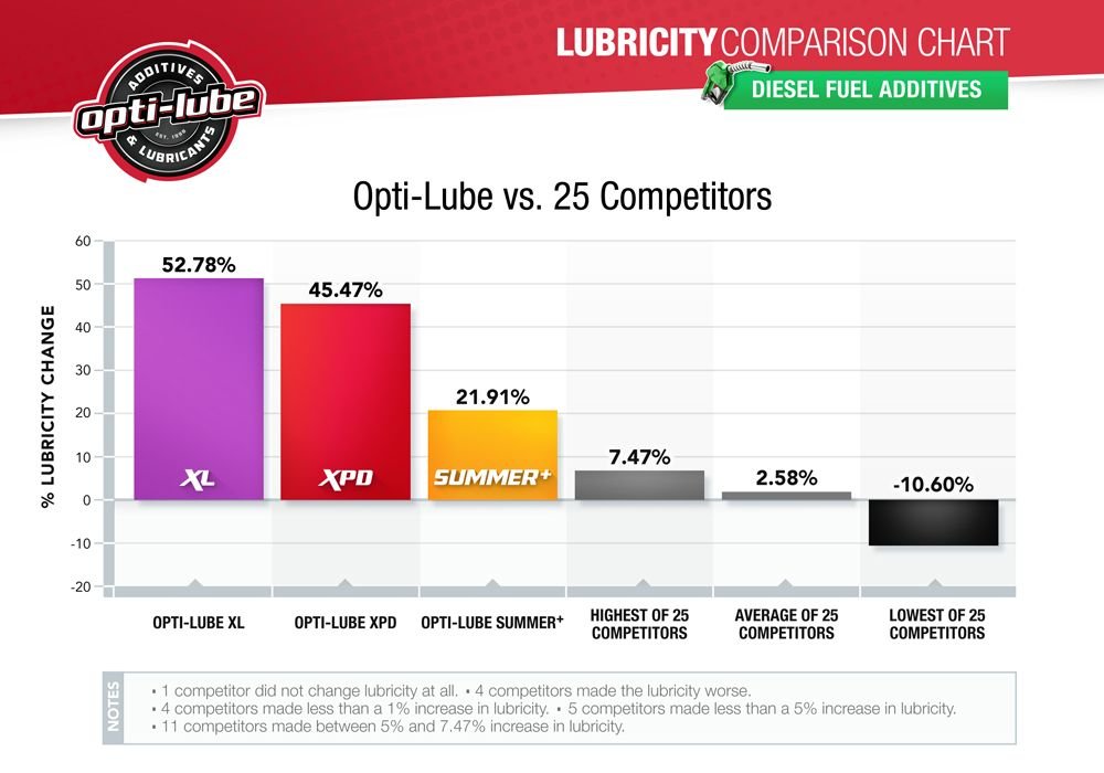

I remember a time here not long ago when Opti Lube was poo pooed here like K100 was because of the alcohol content. People quote the owner's manual but those manuals have been saying the same thing from the 7.3 days; not to use an alcohol based additive. IMO, they were talking about the emergency use de-icer additives that can contained bad alcohol like isopropyl alcohol which would have a detrimental effect on the fuel pumps when it came to lubrication. Mind you, I'm no expert here and offer this only as an opinion. Additives like OptiLube and K100 have alcohol compounds in them but also have added lubrication components as well.
The Optilube All in One fuel additive (they call their RED additive) has no less than 26 components. https://files.elfsightcdn.com/70911b...f19f118579.pdf
Four of those 26 are alcohols. But they do list an ester component at 5% which I would assume is one of their lubricity components. There's also two acids listed as components. After looking into lubricity additives, there's two types; acidic and non- acidic. I don't know what the acid does in this. I believe K100D+ has an acid listed on their SDS sheet. But I do know esters are used for lubricity, hence the non-acidic lubricity component.
Their XL Xtreme lubricant additive (PURPLE) has 17 components listed with the ester component being 40% of the mixture would explain the good lubricity value from this additive. There is also one alcohol listed here in it as well. https://files.elfsightcdn.com/70911b...41d435df99.pdf
Optilube has this on their website. Where's the lab reports that backs this up and shows us how they got to their conclusions?

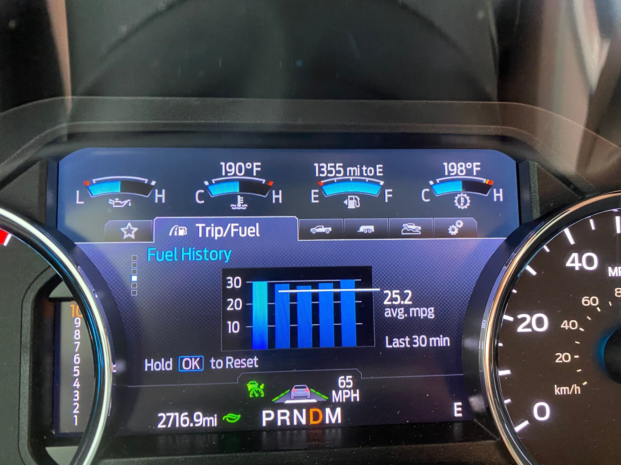

I've had great luck with the Hot Shots EDT and LX4 in my 2020 with the S&B 60g tank. I mix 3oz of each into a bottle. If tank is 1/2 full it gets half otherwise I pour all 6oz in. In ECO mode cruise at 65-70 I was avg 22-25 mpg. I watch the fuel usage history graph in the truck. I also try and fill up at truck stops or high volume stations. Im very happy with the fuel usage for an F350. I think the additives make a big difference.
Appreciate your input.
Those 4 extra gears in the new and improved trans really helps you late model guys out for increased fuel economy.
they sure do, combined with a light foot.
