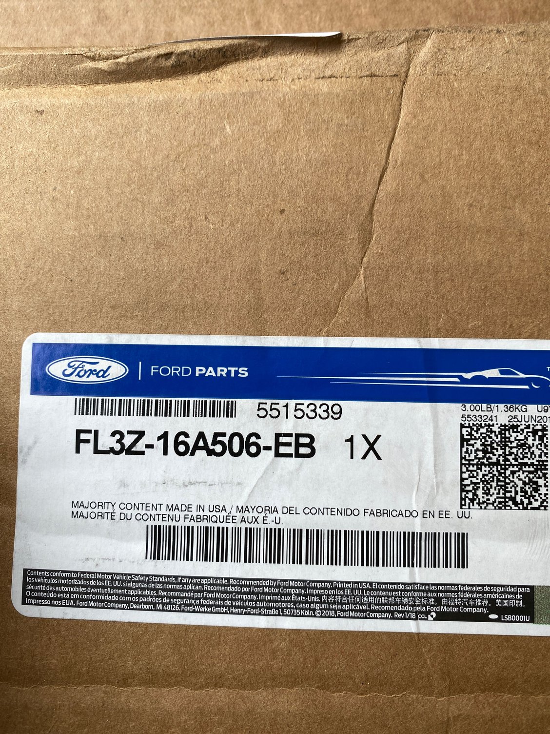

Old Jun 14, 2021 | 04:57 PM
pig9r's Avatar
pig9r
Joined: Sep 2009
Posts: 355
Likes: 44
FL3Z-16A506-EB
Which I will confirm shorty. I just did this in March. When I am where the box is I’ll post a pic of the parts label.

F150 uses four, SD has six, so I used six. They come with hardware to install.
Old Jun 14, 2021 | 10:30 PM
pig9r's Avatar
pig9r
Joined: Sep 2009
Posts: 355
Likes: 44
Found a pic from when I swapped them out.
