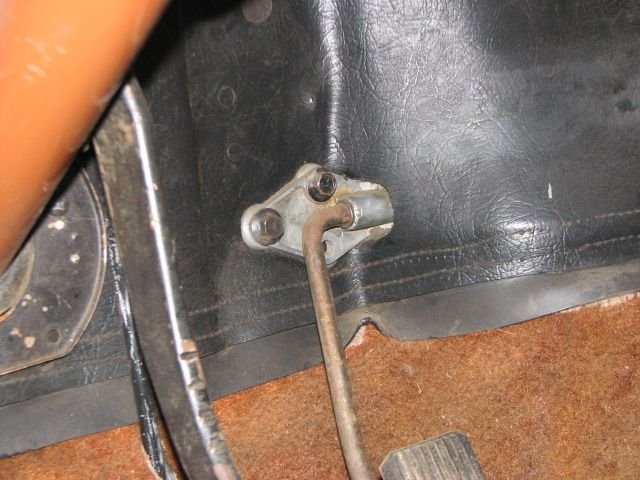

This is the pedal in my 64 with Isuzu diesel conversion.
The pedal was originally out of a Japanese vehicle but I modified it to my preference
Yeah you did. Modified the crap outta that pedal!

Unless you got your negative processed backwards (remember those days?) that looks like a right hand drive with emergency brake handle on far right.
