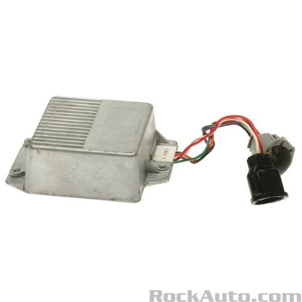

None of the DS II modules EXCEPT the white strain relief had a crank retard. What they did do was adjust dwell during crank to accommodate the 12V the coil gets on crank NOT timing. The dwell was changed on the tail end so it did not affect ignition timing. Also there were no less than 7 different DS II ignition modules. Plus 2 SSI one DS I and one DS III module. I would take what your books says with a grain of salt and to quote "I found in my experience with them that all of the other modules had 3 wiring harnesses" see below one of those supposed other boxes that has 3 harnesses.
This is the module that has crank retard. I was part of the group that designed this box. NONE of the other DS II modules has crank retard and we designed it for a specific Canadian emissions (or should I say lack of emissions) application where we were running a very high initial. This was back when FMofC still had a fair amount of autonomy. Also, try to find one verified account from actual testing of the Blue DS II box retarding on crank. From the factory this was never a feature. The aftermarket boxes who knows what they do. But the original Ford blue boxes have NO crank retard.
And yup 32° total sound about right with modern chamber designs.
