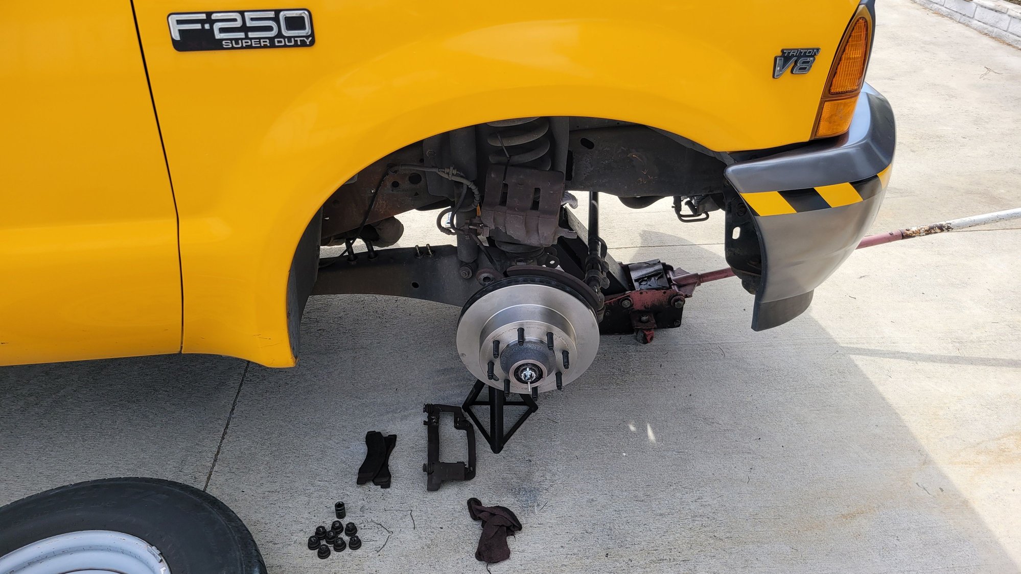

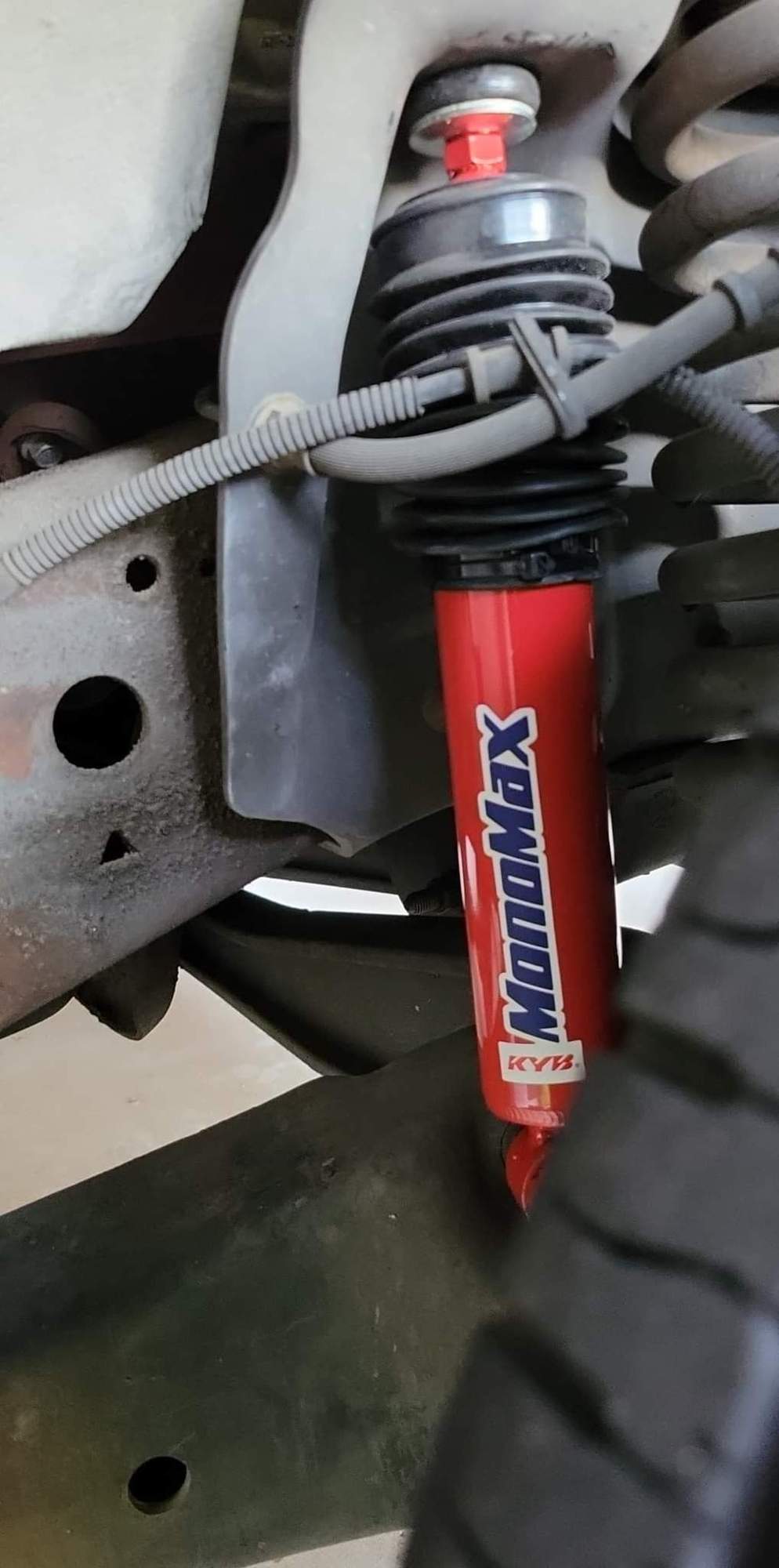

I use the SPC caster/camber bushings. I install a 2-1/4 degree on the left and a 2.5 degree bushing on the right and then adjust them with a 38mm socket until I achieve about 1/4 degree negative camber. I set my toe in to dead zero. Shocks are important, as previously suggested. I use the KYB Monomax on Yello Truck with very good results and it's a reasonably priced replacement.
Another thing I would suggest is to check and measure your steering gear over-center preload. Rebuilding the front end is a great suggestion. I would recommend that you use only top shelf parts, and not plain white box stuff from Amazon...
If you look closely, just below the caliper in this image, you can see the 38mm hex of one of the SPC bushings, rotated into it's maximum caster position.
