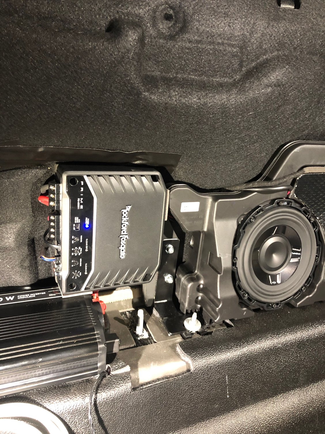

I put a 1100w in mine were the factory one was and ran new wire to the outlets. Ran a wire from the upfiters to trigger it on.
ETA: that’s a lie, I put it on the back wall, not we’re the factory one was. I need a better pic but you can see it here under the amp for the sub.

Nice. But do you have the 360 cameras? I read somewhere on here that the 360 cameras needed the inverter to operate. If you do have them, do they still work?

Lol, nothing related between the inverter and 360 cameras. I have both.
I just unplugged the inverter and tucked away the cables, no codes or issues.
