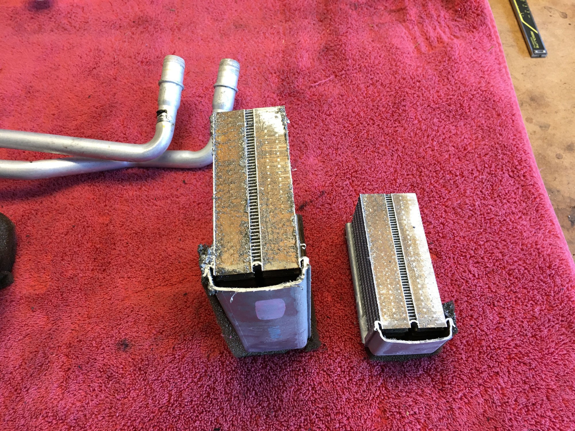

Drove back home to MD yesterday.... started out in the rain and quite cool. Going up over I-787 (NYC bypass) it went up to 220 a few times and right back down to low 200's. On the flat drives never an issue! I'm good with that, I guess but I had never seen that before so I STILL think that the Ford Gold coolant is narrowing the passages in the radiator and/or other passages. Time will tell but as I age, the trips out with the RV are getting fewer and farther between. And then next coolant change I just may change to another coolant (red). This would be after a reverse flush of course.

Oh, I totally agree with that. I haven't cut apart my old radiator, but there was silicate narrowing the passages when I cut open the heater core. In 2008 I flushed with VC-9, Retore, and Restore + more than any sane person ever would. Back-flushed the heater core, too. And after 8 more years of Rotella ELC, it was still there.
