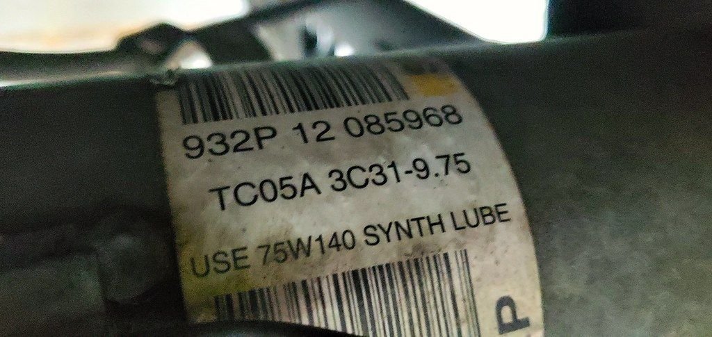

Originally Posted by skatulaki
A previous poster stated to use a mirror and look to see if its clogged up. Since I am not in the habit of lugging a "mirror" around while I'm working, I was wondering if I could take a photo instead and still see what I'm looking for. Since you want to be smart about it, how about you read up as I was mostly reffering to checking to see if the evaporator fins were plugged up ! The other truck I haven't been using lately so I haven't had opportunity to look at that one yet.
Use anything you can to grab a view, camera should work just fine. I used that method to grab a pic of my rear axle id tag to save for future use. Couldn't get my big head between the bottom of the bed and top of the axle where it's at to read it so I held my cell phone about where I thought it would get the pic.
