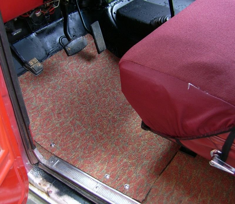

I stripped the carpet and moisture holding padding out, fixed my floors, coated with brushed on rhino bed liner, liberally, ... then used some rubber backed 2'x2' squares of carpet to cut, fit, and then fastened in place with SS 1/4" bugle head screws, SS washers, and I used lock nuts underneath. The rubber backed carpet is stiff, but cuts well with straight edge and knife or band saw. I also made some aluminum under floor shields that those screws and nuts hold up against the floor underneath.
The seats are a set of 1986 50/50 Mercury Grand Marquis Leather like seats which had two center armrests, I think from a 2 door, but in the wider '77 F-150 they are about 4" apart at the center, so I built a drink holder/box for there. I did have to "build" a base for individual seat tracks. Hence ... the seat back release lever.
