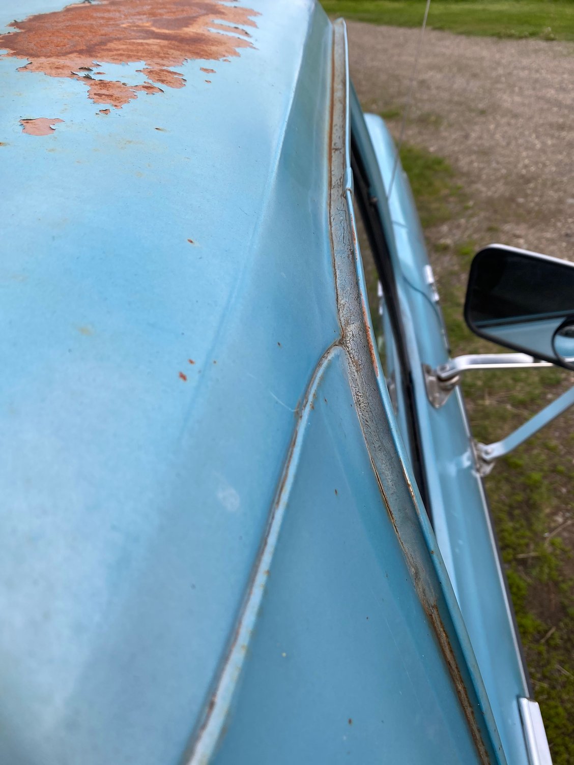

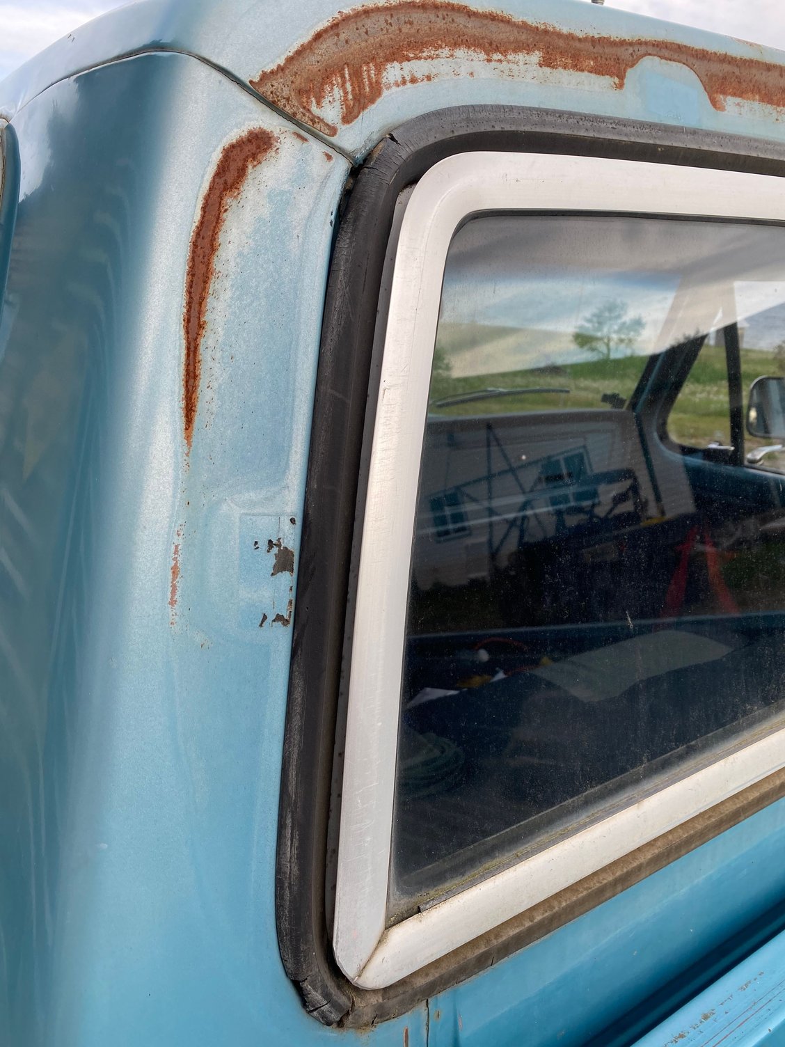

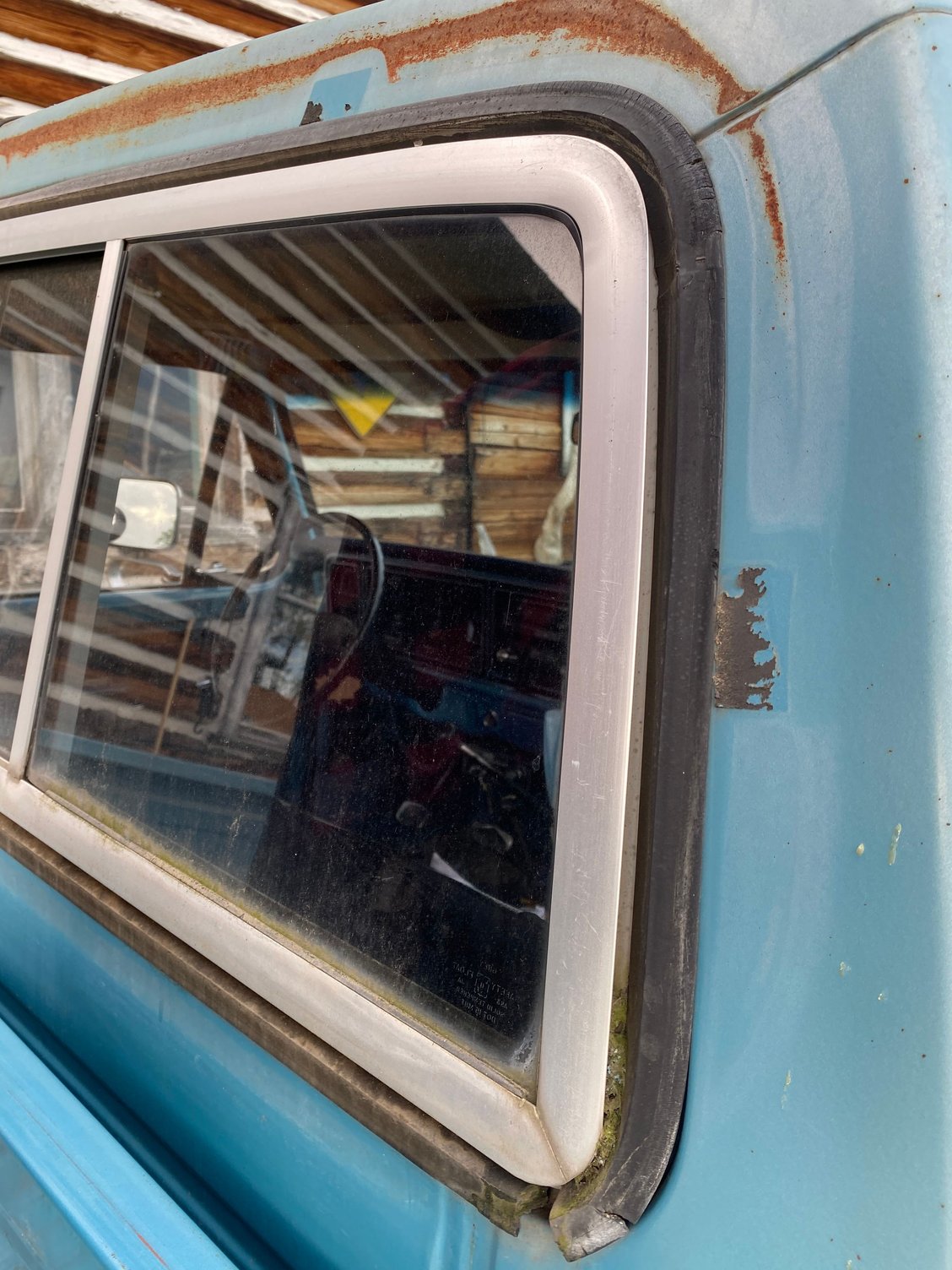

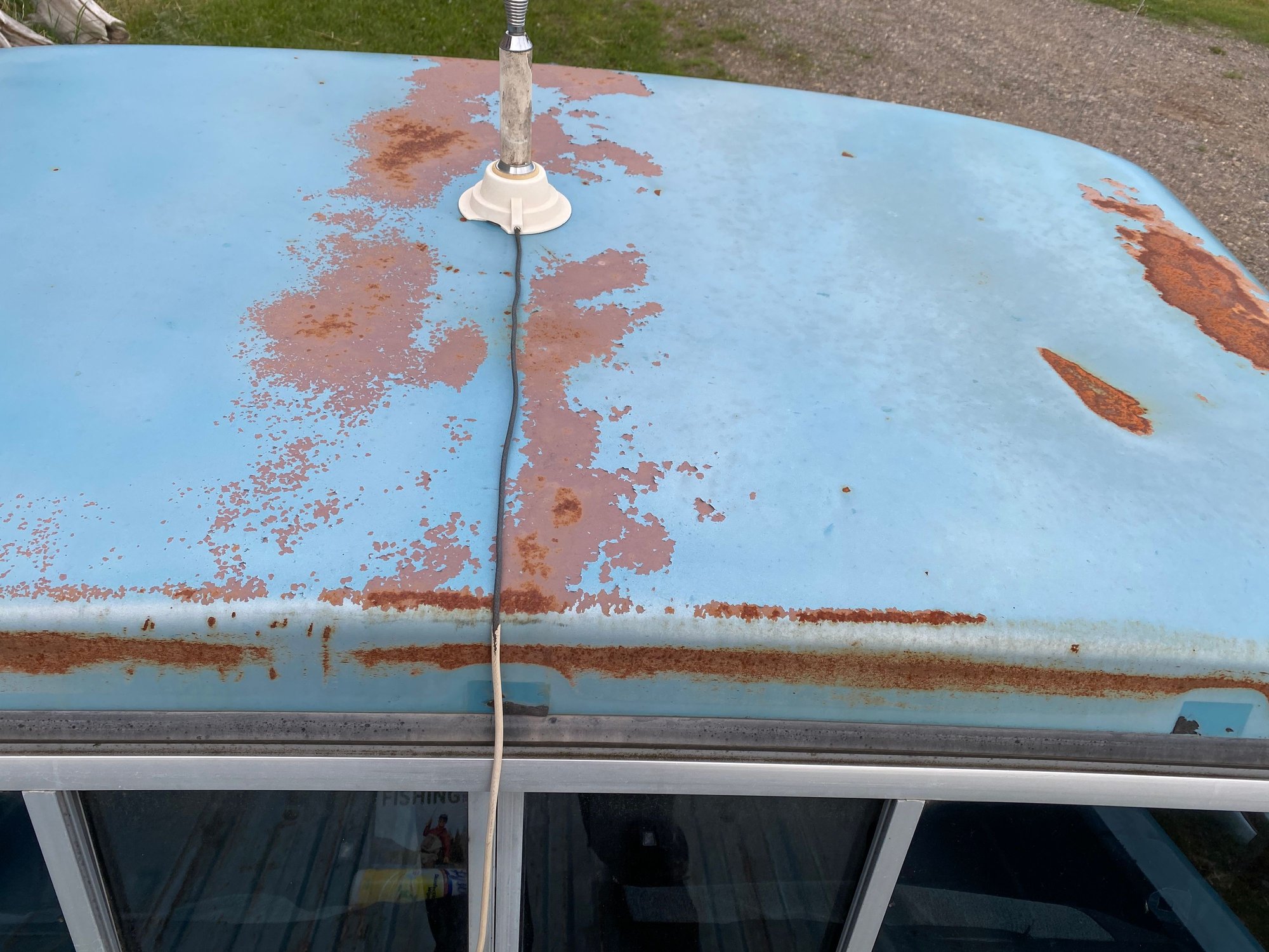

A close look at the pic below reveals rust on Cooter's roof. There is more rust all around the rear window of the cab, from one of those inflatable bladders that sealed the canopy to the cab.
In order to clean up this mess, I have been considering a Regular Tu-Tone upgrade to the roof and upper back cab panel of my truck. My other options include: Try match the 44 year old paint on the rest of the truck, or learn to love patina.
LMC has sent me a pair of bright drip rail moldings along with the bright cab back rail molding set, as well as some nice stainless window visors. Prep will involve removing the canopy and then washing off the rusty roof surface with a 3-M abrasive pad (of some kind?) and perhaps a wire brush? Obviously I will need some Paint & Body type tools; I have an electric pad sander that I use for wood working projects...not exactly sure what else would help?

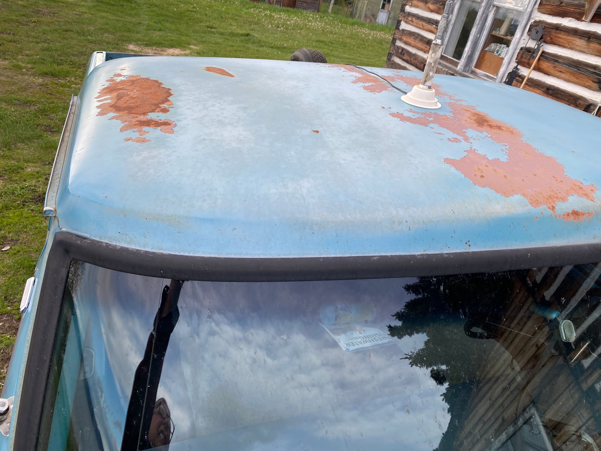

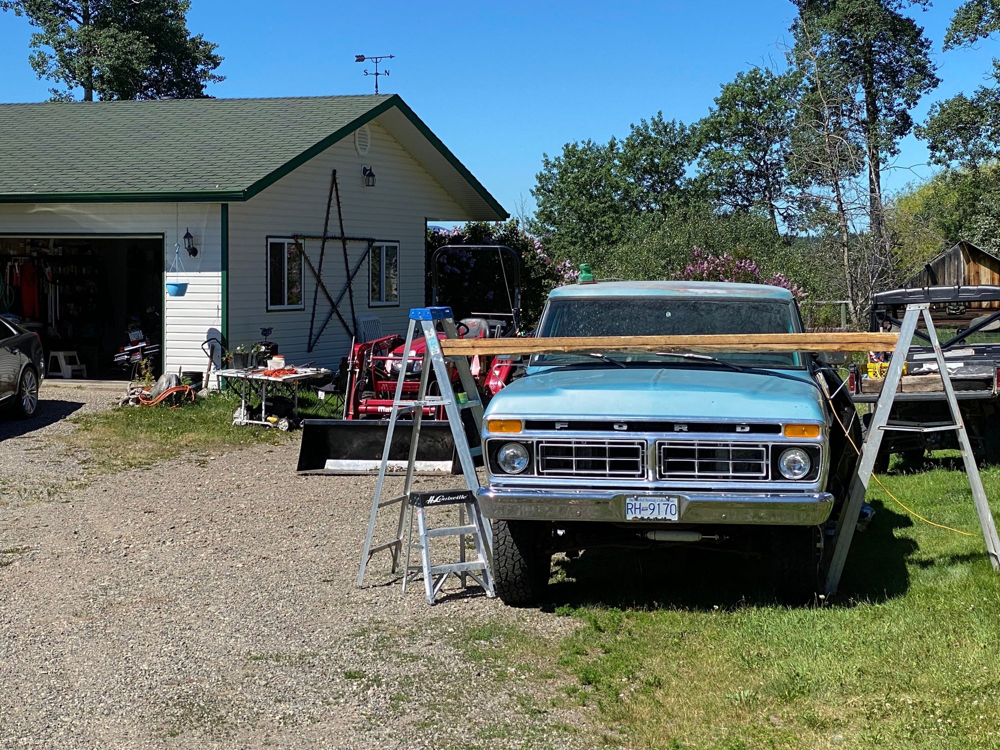

No More Canopy. I think the truck looks better already.
Rusty Roof. "before" pix
The CB antenna is magnetic, so it will come off fast.

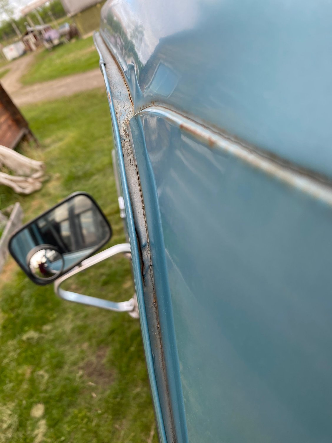

Close-up of passenger roof rust. This is the worst spot, ad may require a bit of filler after I remove all the rust.
The cab back needs some attention too.
I'll be ordering a new rubber seal for the rear window. Can the sliding beer window be refurbished (new felt for the rails, etc.) or should I consider a new one?
The drip rails don't look too bad. This is where the white will stop...with chrome molding to separate the Tu-Tone treatment.

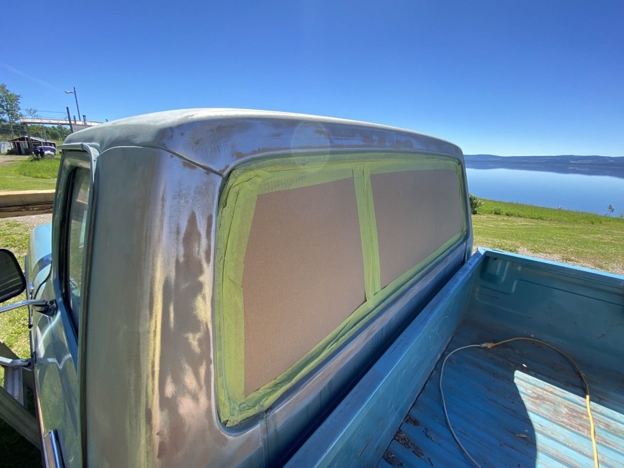

Update: The "heat dome" has passed, and my rt. retina has been re-attached, so here's some pix of a little rust removal.
The large black spots in the middle, and lower right, will get the phosphoric acid treatment...along with a few other small spots. After that, a thorough wash and it's "Off to the paint booth." (hay barn) for some primer.

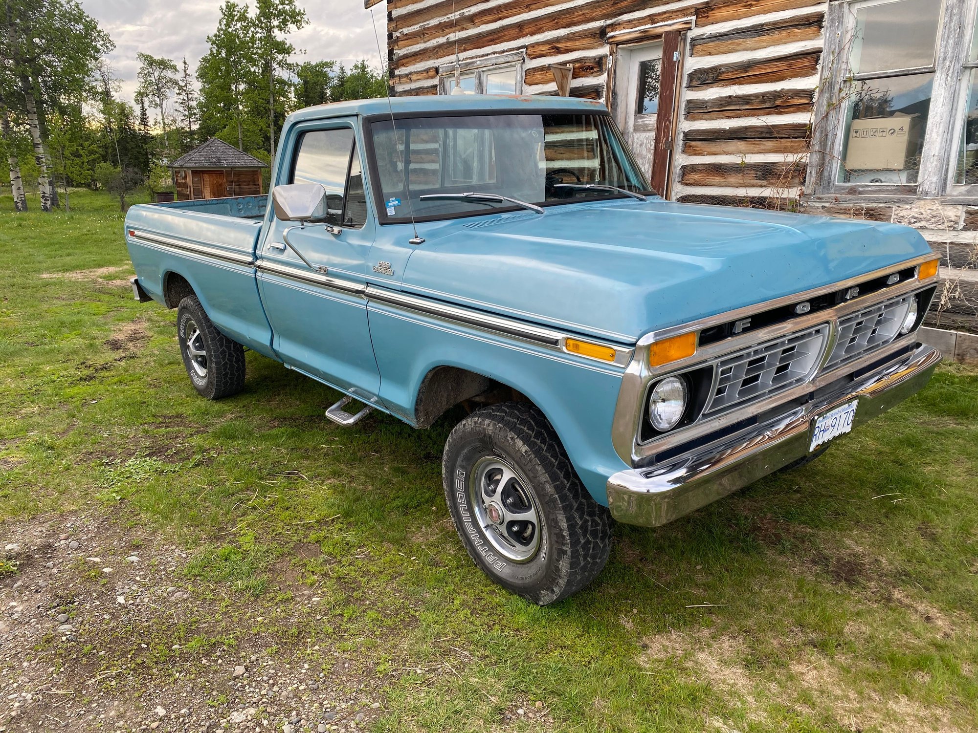

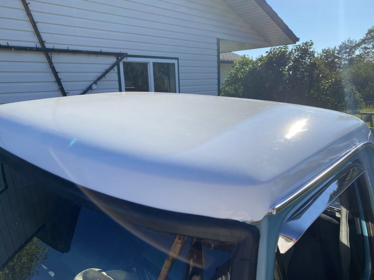

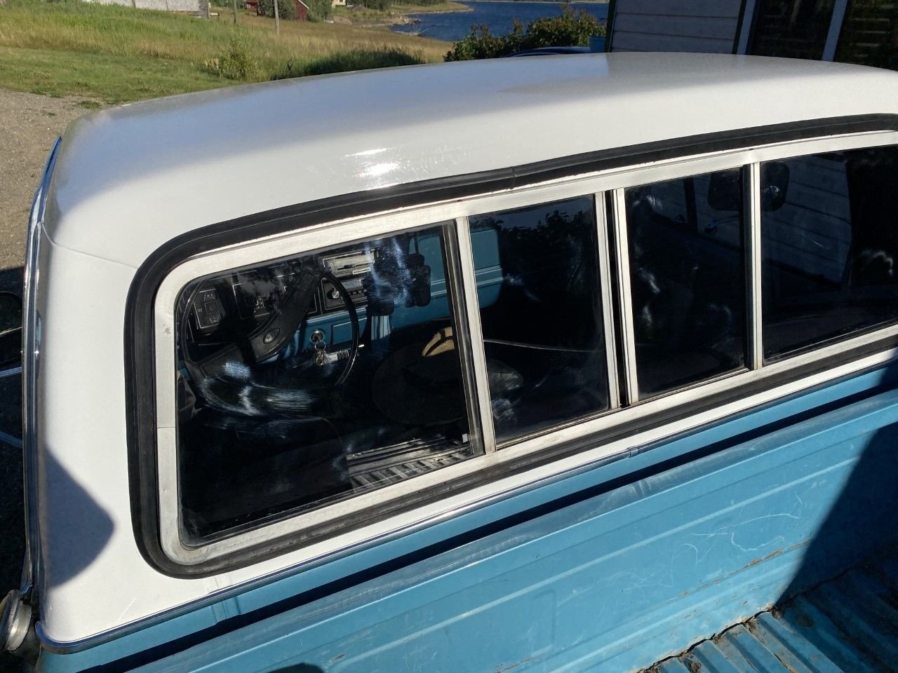

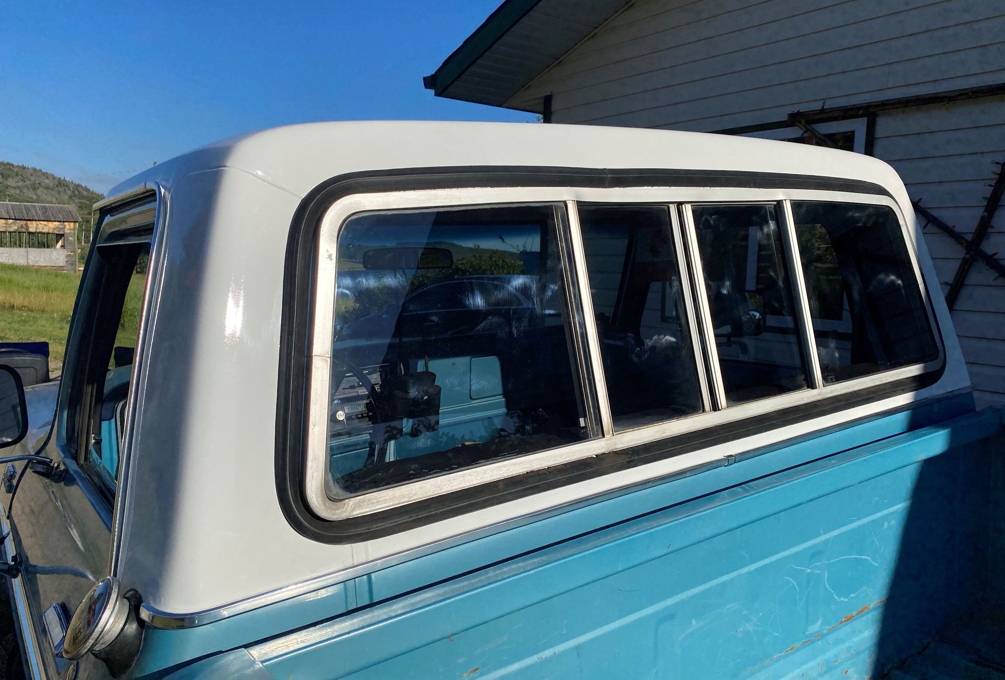

Here's my update: At this point, the prep work was finished and the primers and first top coat was applied.
Then the weather turned cold and rainy for a couple of weeks, so progress ground to a halt. (decided to work inside on the bikes instead) Last weekend the weather was beautyful, so the painting continued.
Here's the results after the slider and belt trim were installed. I sure do like the finished product, especially the Spray Max 2K clear coat. It transformed an average paint job into a professional-looking finish. It was definitely worth the premium price. Thanks ford390gashog for the excellent recommendation. I will be using this product again. Anyhow...here's some pictures to document the results.
I have a great story about the rear window. I made my wife watch a YouTube video about dish soap and nylon twine. I was outside, wrapping the gasket around the slider while she was getting dressed and--from out of nowhere--this guy from Alberta pulls in the driveway and says he saw my truck, so he had to stop? He has 17 old fords, 3 crew cab dent sides, and is currently building one with his son. He is on facebook and some other crappy Ford truck forum, so I invited him to check out FTE and what goes on here. So, he helped me install the slider while she toodled down to the lake for a dip. The window went in with a bit of persuasion (tip: that thin nylon rope is slippery like an eel when soaked with dish soap, so wear thick gloves or suffer blisters on at least 3 fingers) Also, I didn't have small enough rivets on the plastic clips for the belt molding, so I drilled and epoxied screws to simulate the factory-brazed posts. We'll see if that holds'em. I'll get some better pix the next time l abscond with her iPhone. It should be buffed and waxed by then...
