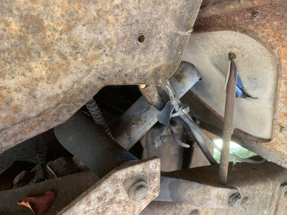

I was watching this video. He does say it's for 1967-1977
The 1961-1965 F100/F250 4x4 and 1966 F250 4x4 uses a different setup more like the 1961-1964 2wd trucks used. The steering gear is very close to the firewall. The column jacket runs from below the steering wheel into the steering gear so the shaft inside is not exposed.
The unit posted by Bloomgren from CJ Ponys parts - if you look at the left side of the steering gear it has a support for the column jacket to fit inside. I believe that should give the support needed on the uphill side. You'd still have to cut the column jacket and shaft somewhere inside of the cab so I don't see how that's a plug and play system, but it looks like it should work. There's also this in the Q&A section. Hopefully that is correct.
