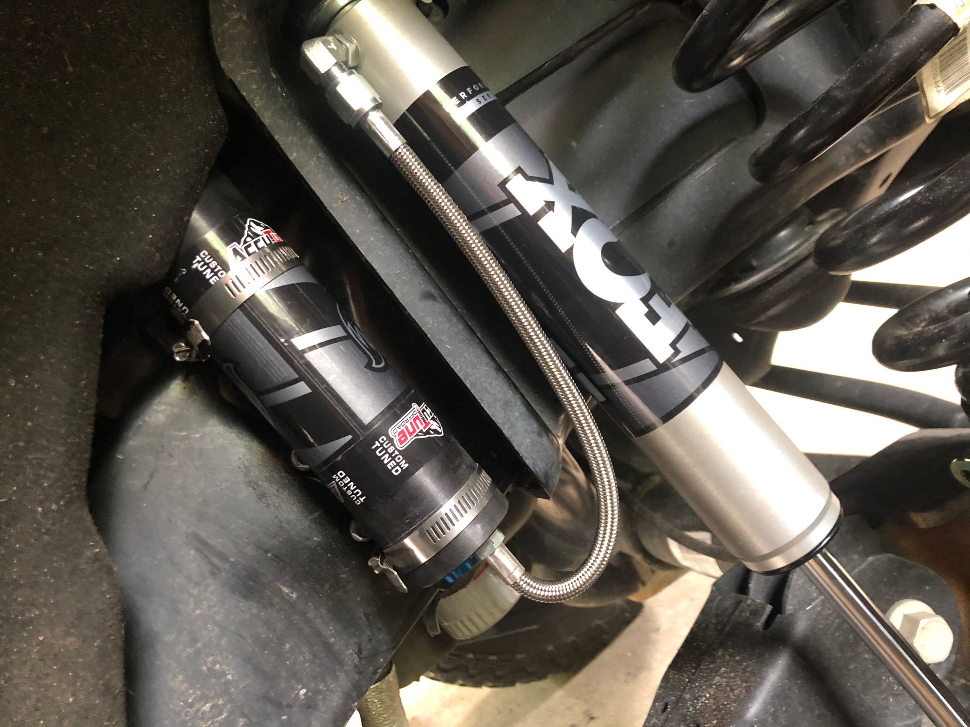

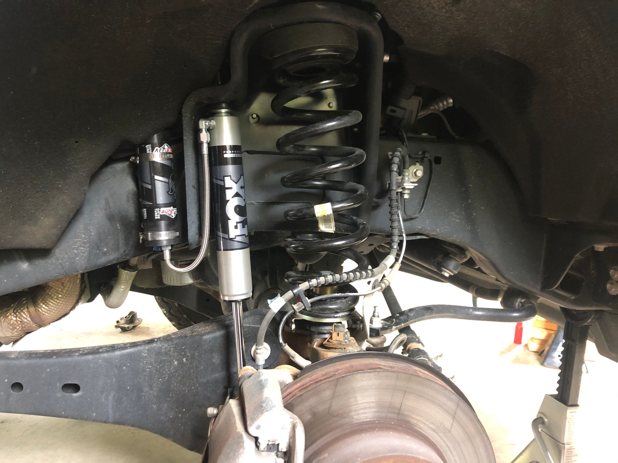

2021 F350 - I don't see many posts on this setup but wow, IMO a killer combo. The OUO adj front spacers are perfect for the 21s I'm only at +25mm and it's the perfect amount of leveling for 35s. The AccuTune'd Fox remote resi with LSC is down right awesome.
At 6k mi the OEM front nitrogen charged shocks would not even expand on their own when I took them off...crap...
I have the OUO drop brackets to put on, but need a bigger breaker bar to get the OE nuts off 😣
