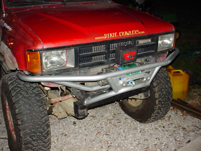

Too busy this weekend building this for a buddy to even think of changing the plugs - maybe next weekend

Originally posted by jcrice
Good job. Can I bring my truck to you for the exaust work when and if it runs again
I don't to exhaust - just playing with the bender and making bumpers and such
