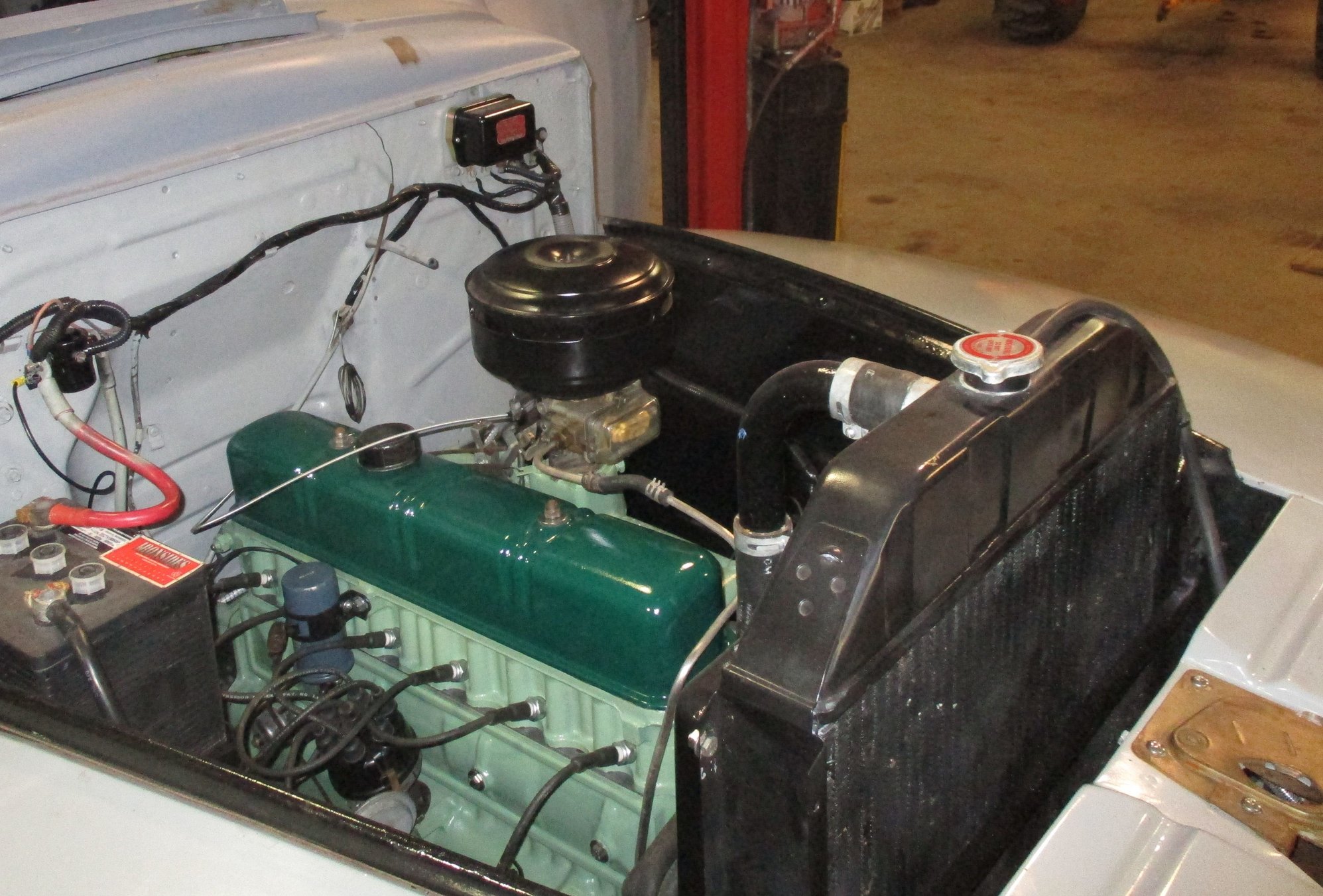

Welcome and good luck with your project! This is what your engine could look like cleaned up:
My engine is a 52 rated at 101 hp. Yours will be bored out a bit and have a few more hp. Both versions of our engine were quite comparable in power to the Ford flat head V8's.

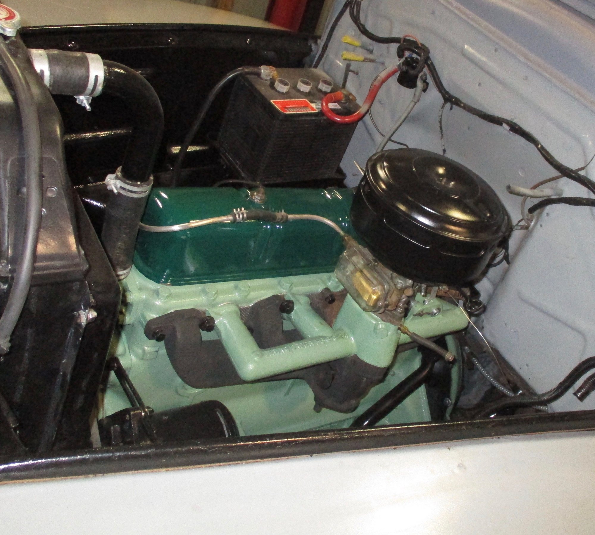

Nice I like it. Good luck with it. Here is my 54.

With a prettier 53 grille
