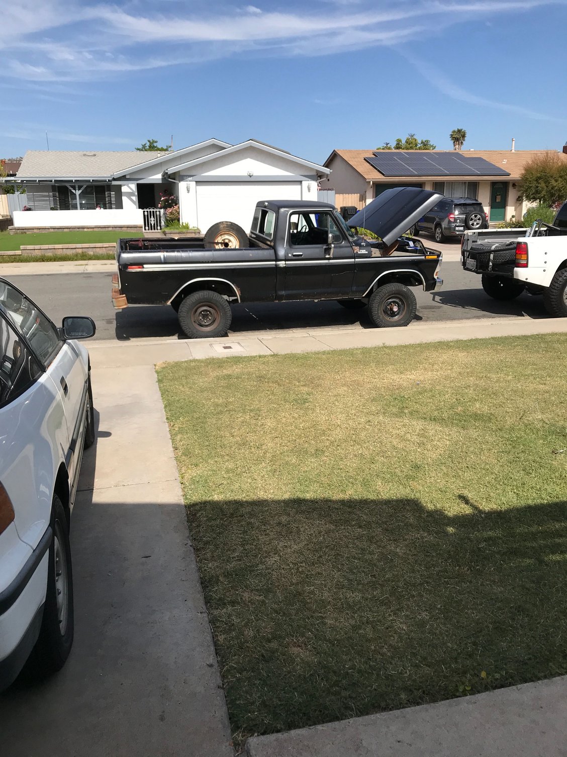

Also besides the axle internals I just finished pretty much a full mechanical rebuild and replace of everything on the truck including the steering box. The thing was so dirty and rusty by time I wire brushed it clean there wasn’t any obvious colors on the box that would help me tell you guys if it was red or blue
You can see it doesn’t sit too high. Maybe an inch higher than the rear with stock springs. So 8* of caster should be more than enough

my problem with what you’re suggesting is that it all is already new or rebuilt. I’m going to get a brand new steering gear just because I feel like that is worth it and look into some solutions for pitman arm drops and track bar risers to fix the suspension geometry. I’ll see if I can find good springs or spacer that keep the ride height I’m at but I don’t want to go any lower once I put 33s on.
im kind of doing a balancing act of looks and performance on and off road.
