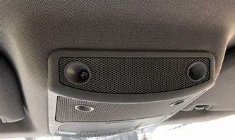

Those 4 little things on the overhead console that look like lights, but don't light up. Those are your sensors that tripped when you threw your shirt in.

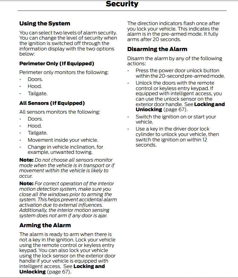

I would like to find a way to set the parameter to default to perimeter only instead of both inside and outside. I always leave the pup in the truck and unless I choose that everytime I lock up the pup will set the alarm off.

Dashboard setting under advanced should allow you to toggle what sensors are activated. It's been a while since I had to go look,I told the system to stop bothering me and it no longer asks. Page 79 of the 2020 owners manual does give guidance on what options are available.

There are four little "ports" on the overhead console. 2 point down and 2 point towards the back seat. First time I sat in a Super Duty I kept trying to turn on what I thought were little lights. They're not lights, they are motion detectors.
I thought they were LEDs. They are motion detectors.
