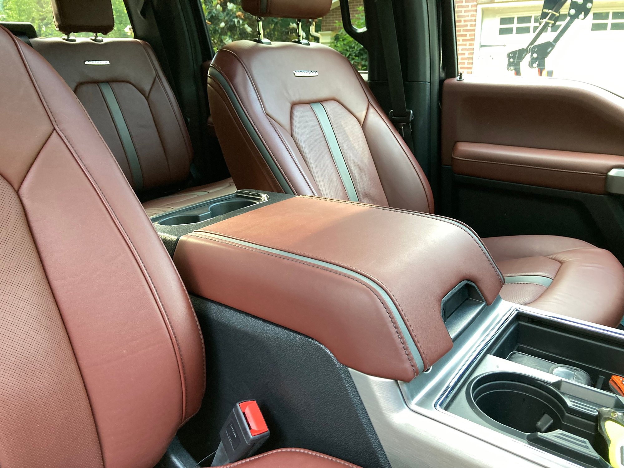

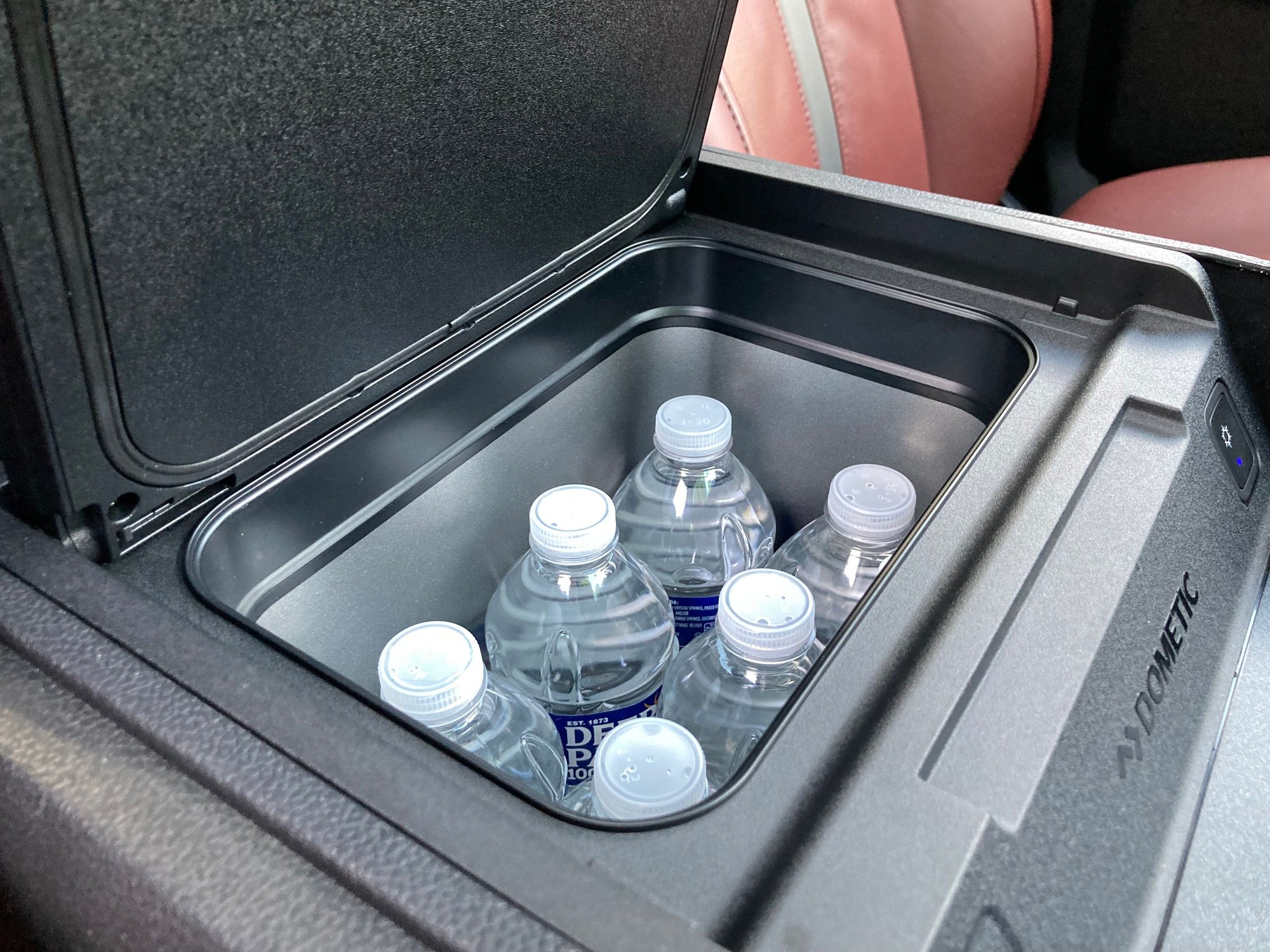

Dometic is presently having a 20%-off sale, and I bought a CCF-T from them. It fits all 2017+ Super Duty models with a console, as well as F150 and Expedition models that share the same console. The installation is basically drop-in. It gets power from a 12V plug inserted into outlet in the bottom of the console. The only modification required is a 3.5" hole in the interior forward wall of the storage area, and a plastic template is included for precise locating of the hole. Into the hole fits a fan. Should one decide to remove the unit, a plug is included to close off the big hole.
Foam insulator spacers go on the left and right interior walls of the console, the fan is plugged in, power is plugged in, and the unit sits into the hole. A couple of retaining screws are tightened, and a trim piece snaps in to cover up the front end. Easy.
All in all, the best modification I've seen for under $500.

Looks great! No condensation drain holes? What happens to all the water?
Here are the instructions.
They identify internal condensation indicates seal issues.
Yeah, opening and closing the lid is a pretty well known seal issue!
I know in a residential fridge that is thermostat-regulated and generally always connected to power, they don't deal with condensation unless someone leaves the door open. I see this more like a camper fridge where it's only going to run while the truck's running and will constantly run through cool/heat cycles. The camper fridge has a drain pan under the cooling coils which drain to the outside and I have to put a towel in the bottom of the fridge and prop the door open to catch any of the other condensation. I would imagine this unit goes through the same cycle every night. Also, if the insulation is thin, the outside of the unit as a whole can sweat which could create issues in the console, which is more what I'd be concerned with. I'm just used to seeing some sort of drip tray or condensate line with a fridge.
It is unlikely this toggles from cool to heat, like a frost free home 'fridge. It very likely only operates only in cooling mode.
It is also likely that this will never develop frost, as it is a 'fridge only, not a freezer. So the previously mentioned condensation is the only effect.
As such, no drain is provided or required.
