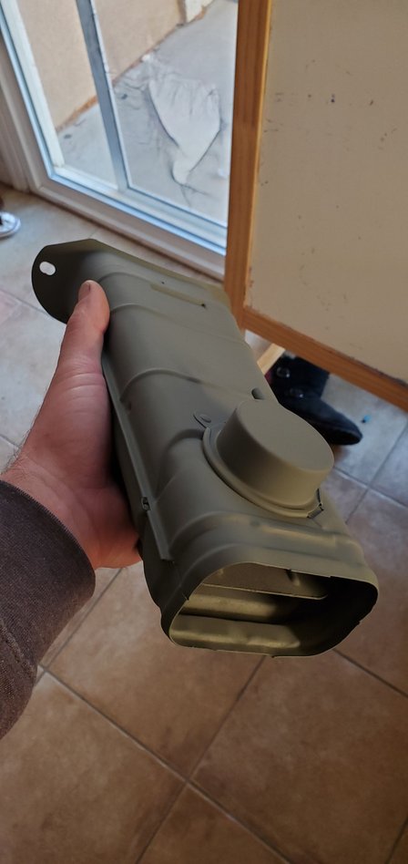

Intake heat bypass diaphragm
Anyone know if this is repairable? Mine won't hold vacuum. I know its kind of a weird thing but I'm trying to factoryish

No, But new ones were available back in the day...and it may still be available try calling the dealer part number CX-898

Yup still available new

Freaking sweet guys thanks

That piece will be important if you drive your truck in the winter where it gets cold. I see you live in CA. It gets cold in some places correct? That is considered part of the emissions system, but it sure makes it run better in the winter.
yeah I'm in the bay area doesn't get cold cold, coldest iv ever seen it was 28 degrees. But that was a wild winter. Usually only gets down to 38-45 . But I'm wondering if that plus a better carb/ choke adjustment will help with cold starts.
now does anyone have a part number for the thermal valve the warm air diverter uses for vacuum?

If you find a new vacuum switch, or try to get the old one working, I found out it matters which port is the vacuum source and which port goes to the actuator. If you get them backwards, it will activate the flapper valve and never release it. When it's right, it will actually modulate the valve in midway positions also, it's more than a switch.
They usually put a doo-hickey in the line to the actuator also. I am not sure, but I am thinking this is a orifice to keep the valve somewhat steady if you dog the engine and the vacuum source goes high and then low. Not sure how important that would be.

Thanks for the replies everyone . I decided im just gonna run one to help out with cold start. Built this guy . Gotta get a intake cleaner housing riser and I'm going to relocate the oil cap breather filter to the rear of the cleaner housing. Replacing stuff as I go about it
